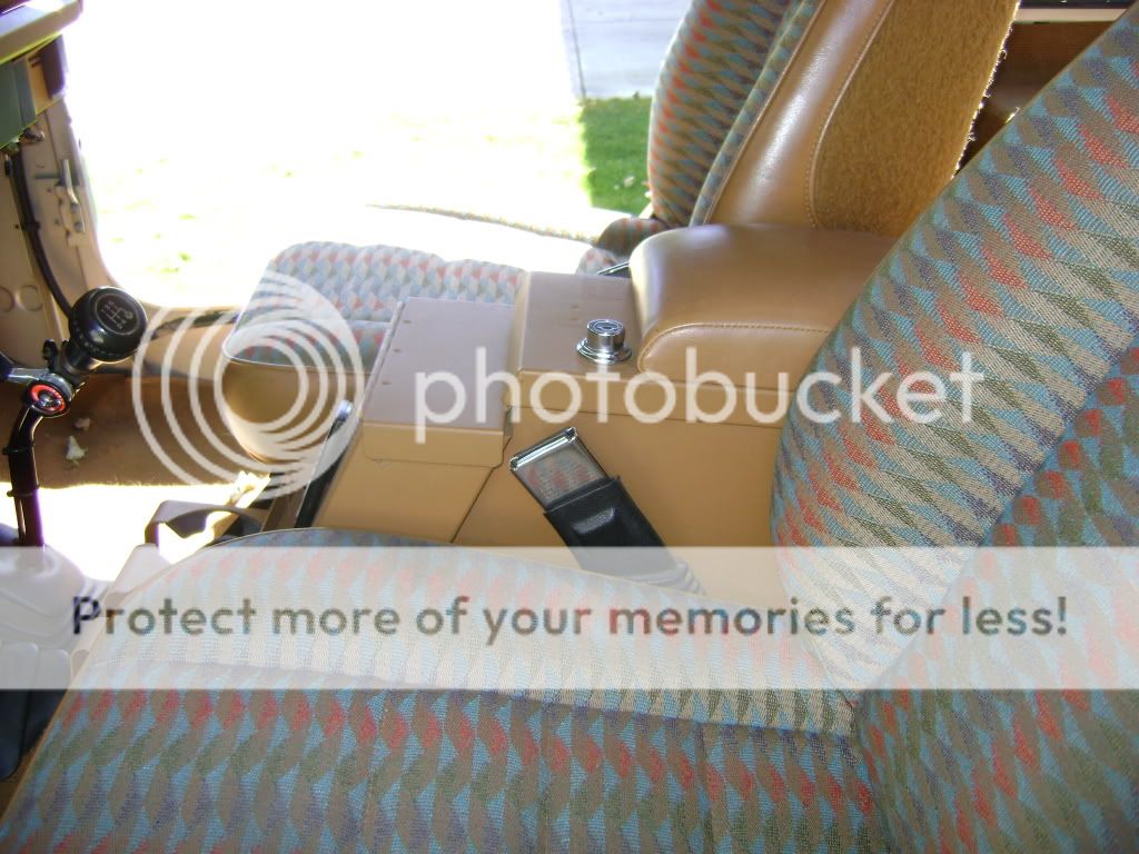

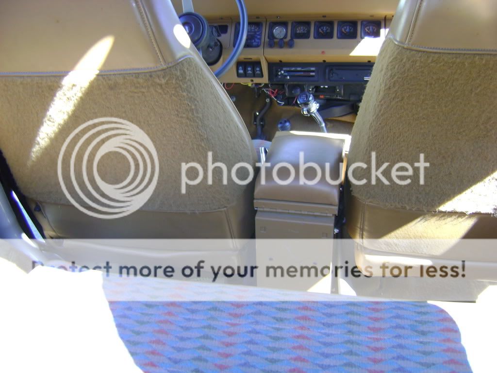

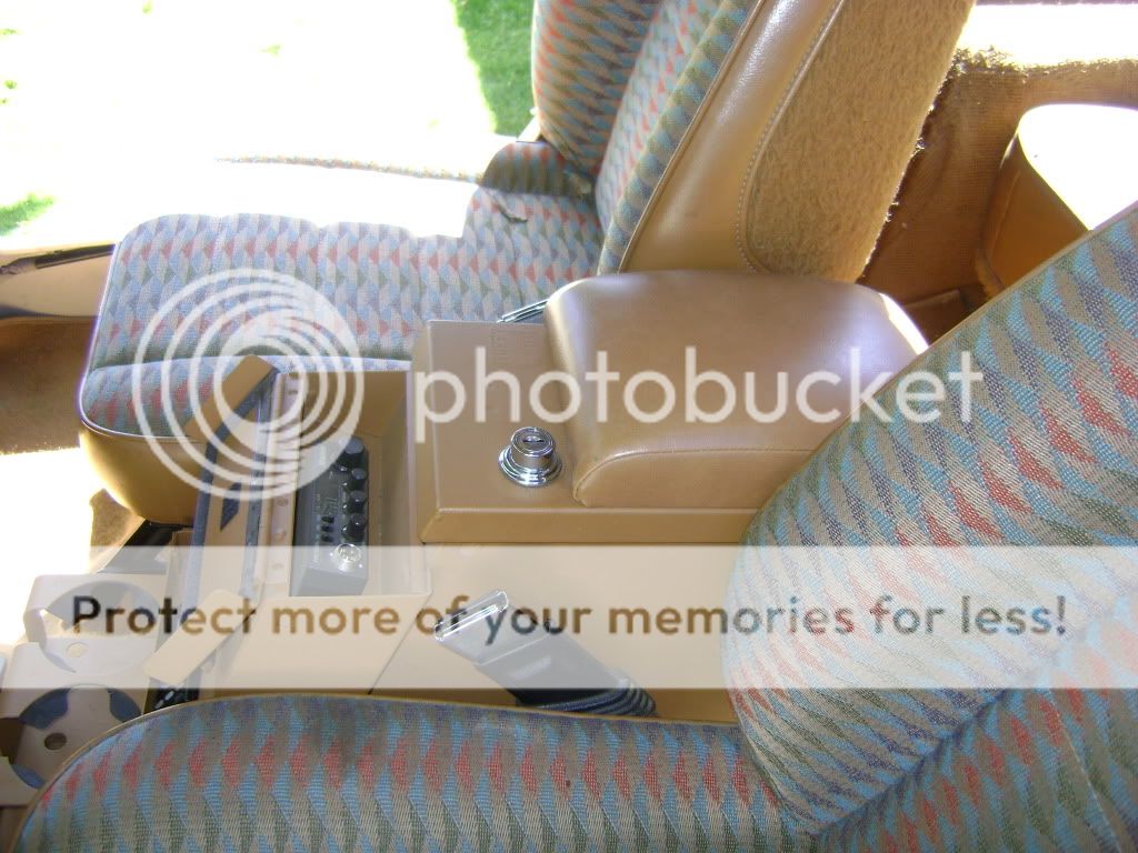

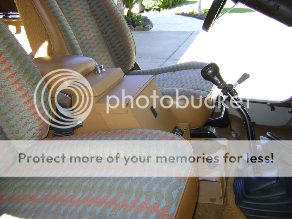

1972 CJ5
Join Date: Oct 2012
Location: Chino
Posts: 3,019
Originally Posted by zombiechief View Post
Hey WSS, which console is that? How do the wires get routed into it? Can you give a little detail on your console? I've been thinking of modifying my .50 cal can console for my 2M, CB and 1 way too.
73's!
N2GNZ
I bought a dealer demo unit off of ebay to start with. I really wanted Tuffy quality but didn't want to part with the cash LOL. The demo had a large cut out on the side to show the features. I cut a piece of 16ga sheet to cover it. The console is mounted to the rollcage same as the seats. It has a 200a master switch to prevent theft , so I used that power in the console to power the 12v plugs on the back as well as the led dome lights in the rear section. There is one of these in the bottom to distribute the power:
http://www.12voltguy.com/1-WIRE-FUSE-BLOCKS.html
I hole sawed and grommet-ed a 1.5" hole on the bottom to run the cables and wires. To paint, I used a couple cans of undercoating paint. Powdercoat would have been better but it works. The way the fuse block is mounted, I did lose the bottom four inches or so of storage, so the holster had to go on the outside. No big deal though. I got a lot accomplished with the space I had.
Tommy
KF6KIH
