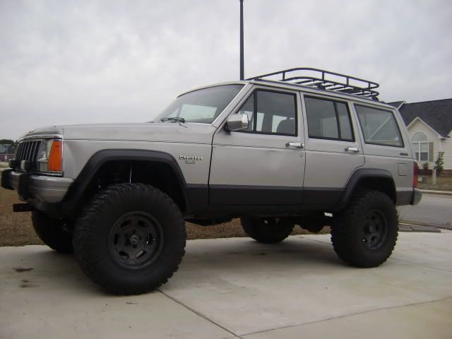

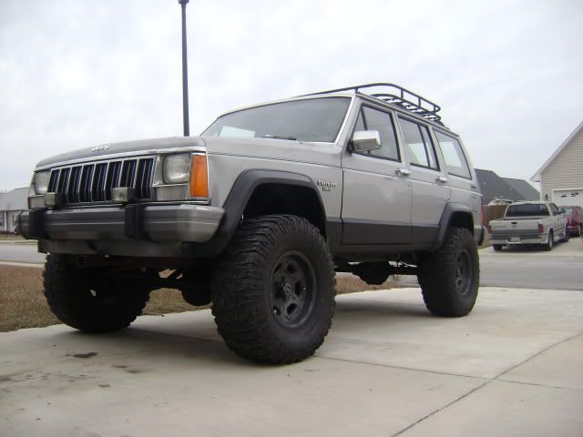

Ok...I finally got the 4.5" RC AAL lift on along with pro comp 33's. The first pic is of my HEEP the day I bought it. The 2nd is after new wheels and some bedliner, and the others are the other day after finishing the lift. I'm rubbing pretty badly on the rear of the front passenger's side tire, so I will be trimming shortly.
do you think you would rub with 33x10.5's?
