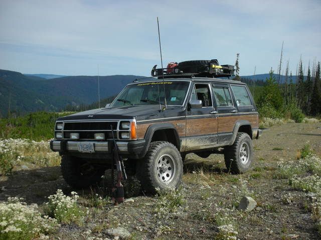

mud-dog27
1989
Join Date: Sep 2005
Location: Aldergrove , British Columbia, Canada
Posts: 1,098
it all depends on the lift kit....im runnin a RC 4.5" w/ full packs and 32s no trimming and i get no body contact and i could probly fit 33s in there with mininmal trimming only thing my tires touch are LCA at full turn
not the best pic but theres still plenty of room for 33s in there
89 wagoneer LTD. , 32x11.5R15 wild country RVT, 15x8 AR baja rims , surco safari roofrack w/spare tire kit , cobra 19 DXIII w/ high gear mic. 4' whip on a 3" heavy-duty spring , 4.5" rough country full leaf pack lift kit
