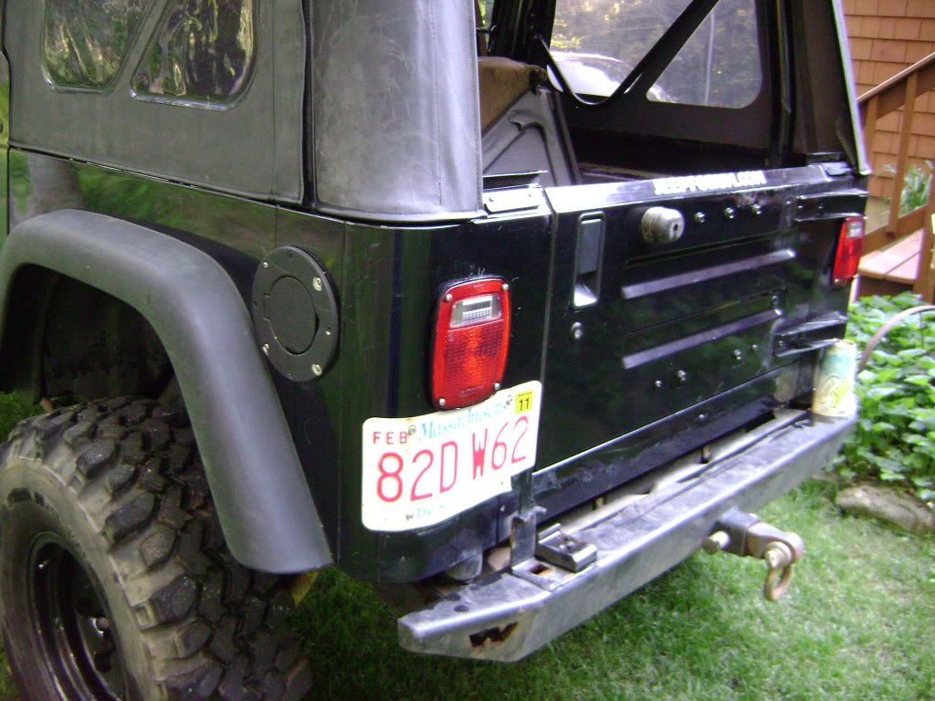

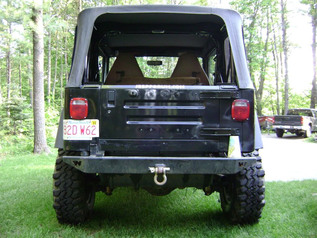

Stock taillights, 1 hr of total work, scribing with a flathead outlining the bucket of the light, pair of sheetmetal cutters, put a ground on the pertruding bolts inside the tub for each light, drilled small pilot hole for the existing screws to hold the taillight in. I ended up drilling two of the screw holes in the light cover so that i could mount the bucket and remove the lens without the bucket coming with it. I'm happy with it
