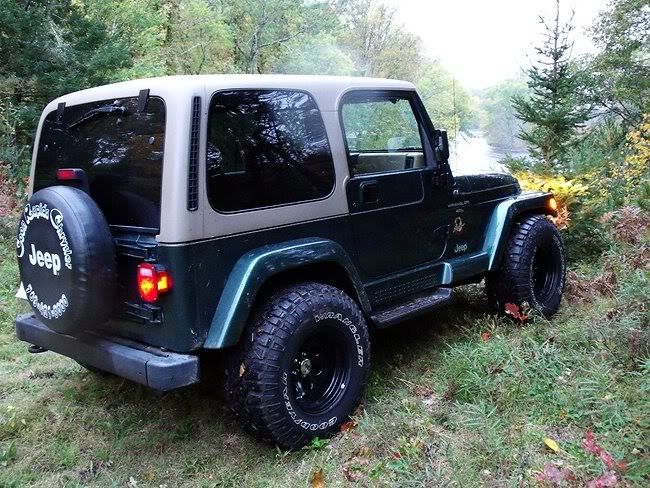

No Lift 33x12.5x15
No rubs lock to lock, but tons riding anything but pavement...
Lift is in the garage waiting for time in my schedual

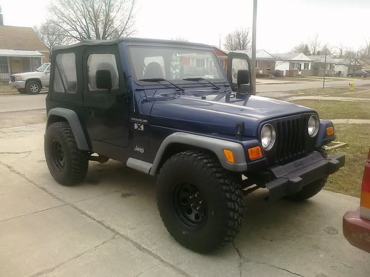

My gf's dad needed tires bad on his XJ so I threw my gf's 30's on his XJ and threw my old 33x10.5x15's on her stock TJ with 15x8 wheels with 4" backspacing. 0 rubbing anywhere during daily driving, but I would never suggest off-roading it without at very least loosing the front and rear fender flairs and checking for proper bump stop length.
I've been to busy to put her 3" BDS lift on, but knowing her she'll get me to install it real soon.
