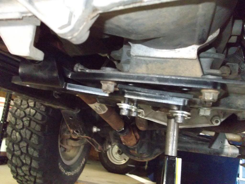

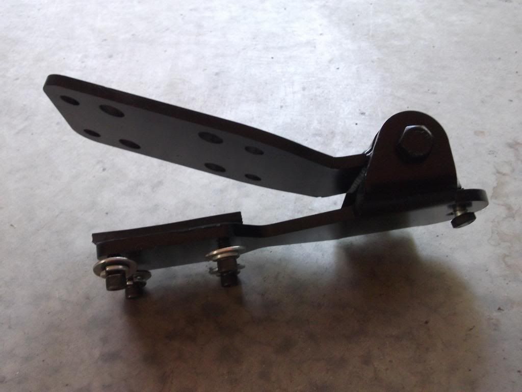

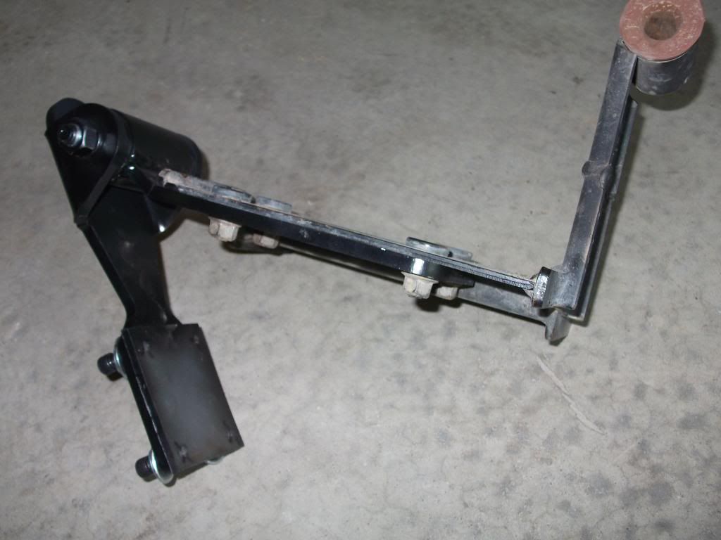

This is on the NV3500 on my 2004 TJ but I wouldn't think there would be a huge difference.
As far as how much to take off, it's a trial and fit game. I would grind awhile and then mock it up, repeat...

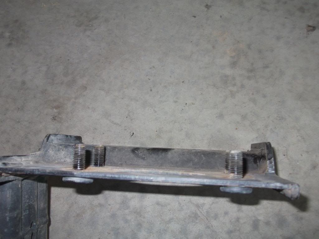

Yes, the 4 allen head bolts are part of what holds it to the skid.
You will of course still use the 6 bolts to the frame and then this also had a 9/16" bolt in addition to the 4 allen head.
It will make more sence once you have it in hand and can look at it.

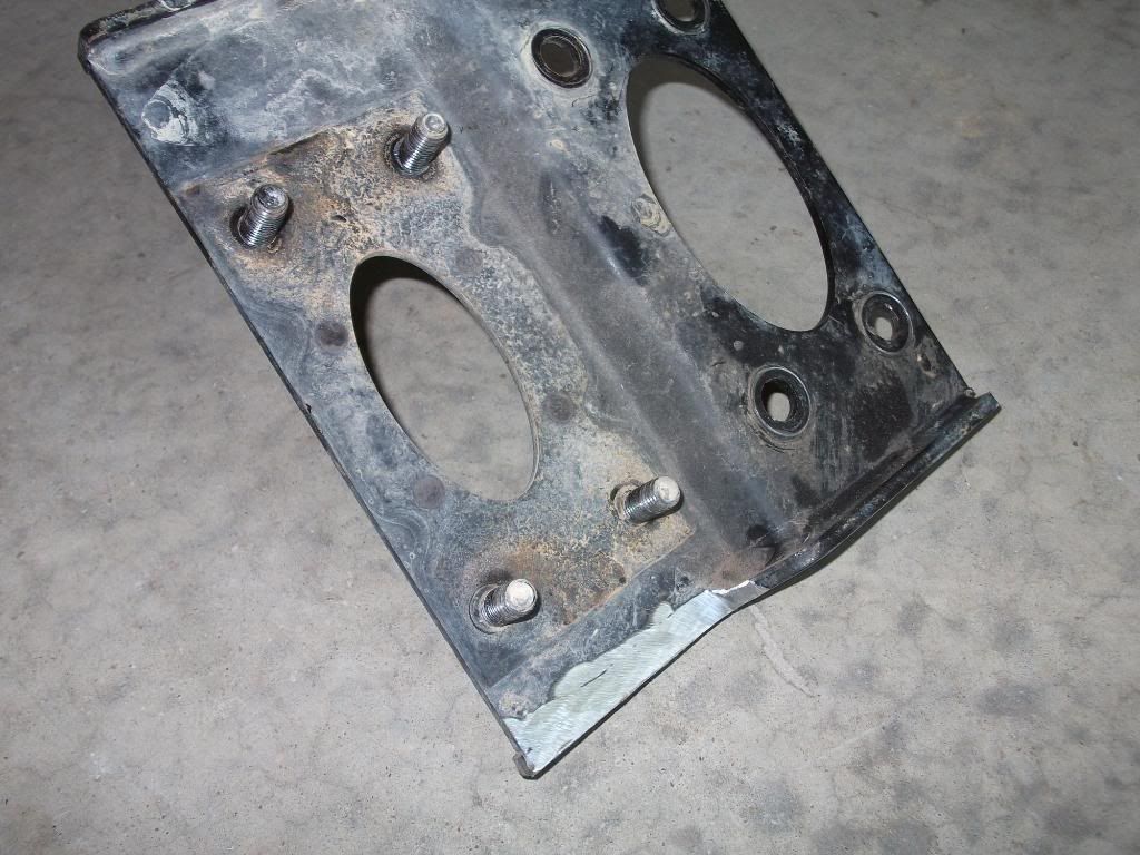

That pretty much sums it up. It took me probably half a dozen test fits to get it right.

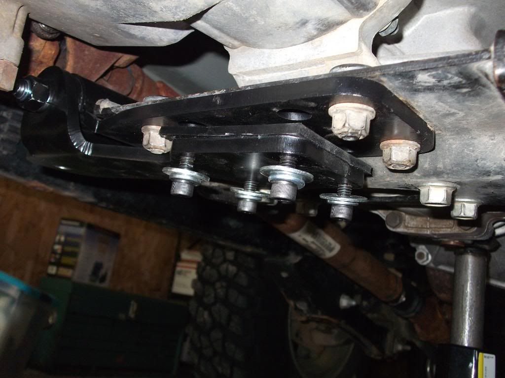

In addition to with where most have to trim I had to trim the other section as well, not much but it was just barely rubbing. Not the best pic but i you get the point.
