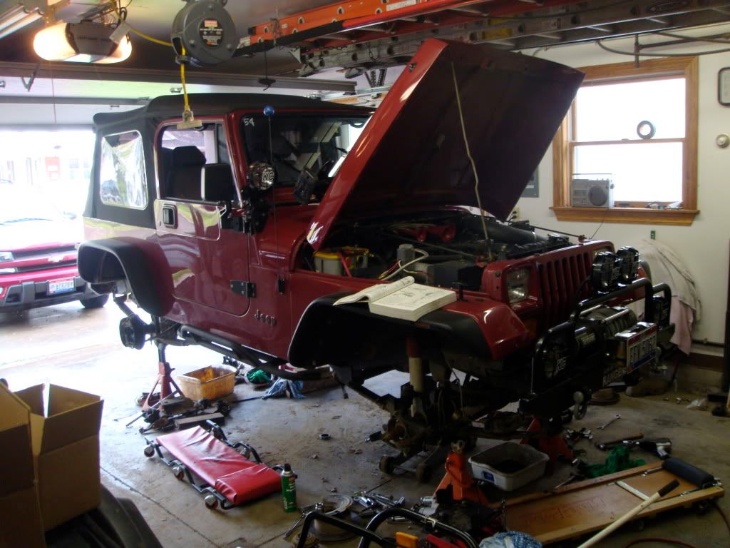

And since you posted this in the picture request section, here's a picture of transmission problems:
1992 YJ Wrangler 4.0L, NV3550, 2.5" suspension lift, 32" BFG M/Ts, lots of other cool stuff
