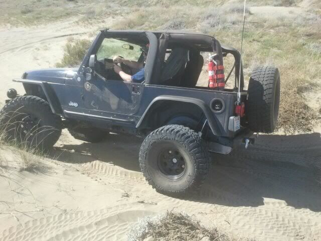

JMO, but with Metalcloak fenders, I think 3" springs are plenty enough to run 35's with a 1.25" body lift.
For reference, I am running 3" springs, 1.25" BL, and 35's. I had to adjust my bumpstops just a little bit to keep the tires out of the fenders. If I had Metalcloaks, there would be more than enough room.
Someday, I hope to get their aluminum fronts and rears.

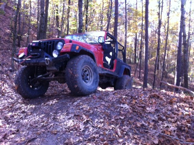

This is what I run, minus the Metalcloaks.
1999 TJ Sport with a few mods

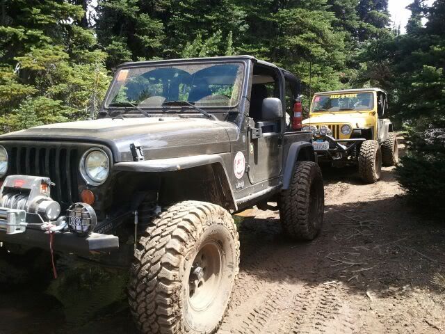

Currie 4" with the Savvy 1.25 " BL for the under armor

Very nice looking jeep!

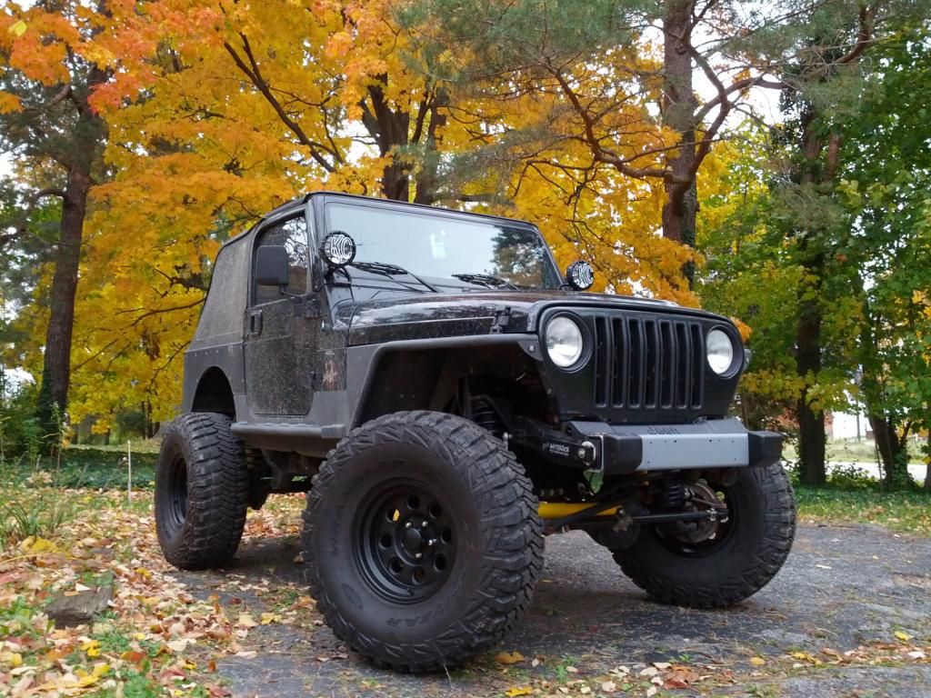

4" short arm and 1.25 body lift and 35s

The pic of my Jeep I posted above has the items you asked for. Outboarded rear shocks and relocated stock upper coil perches, neither of which affected ride height.

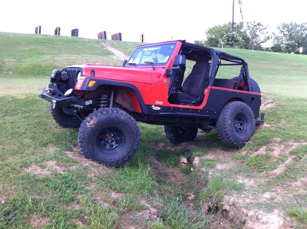

5" of lift seems to be a lot of lift for 35s. Espicially with MC fenders.
I used to run 3.5" SL and 1.25" BL and always felt us easy where I wheel (lots of hills) from the suspension unloading.
Here is mine 3.5" + 1.25" on 35s and stock fenders bumpstopped correctly. Never close to the stock fenders.
