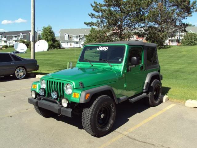

Pulled the milkjugs, added a Rugged Ridge light hoop and a pair of KC Slims.

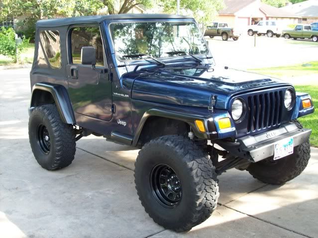

cut it and painted it.

I'm very interested in making a similar mod to my stock bumpers, but am looking for a bit of information...first off, what did you use to cut it?...second of all, what is the best option to use for painting?
last but not least, mounting a wench to the stock bumper.....what all would be needed to make this dream a reality?

i personally use a grinder with a cut-off wheel. some people use a recip. saw. i think the grinder gives a better/cleaner cut.
for painting, i just used some Rustoleum satin black spray paint after lightly sanding it down just to get any surface junk off of it.
for mounting a winch, you will need a winch plate such as this one from Rough Country:
Jeep Winch Mounting Plate
