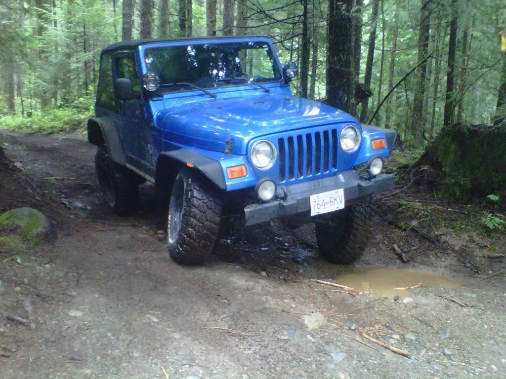

It's a good kit. Make sure your setting up for 33's and not 35's. Yeah - i said the same thing.
Heres an alternative to the "2.5" ome w/ BL.
OME ZJ/LJ Lift(2.5", just tougher coils to compensate for the heavy v8/LJ rear ends), Long travel shocks and all 8 RE arms (yeah yeah, they work great but should have put my money else where)
I got more than 2.5" initially and still is more. I dunno like 3-3.5"?
Clears 33s just fine without the BL.
With BL i'm thinking i should be good for 35s, but we'll see..

No it's not its a different part number.
Its not actually meant for the TJ right. Its for the ZJ / LJ, but when I called northridge4x4 they suggested it.
A lot of guys have to do the 1.25" BL to make sure 33's dont rub. I, however did not. Perhaps that's related to the coils I got in the ZJ/LJ part # I'm not sure.
