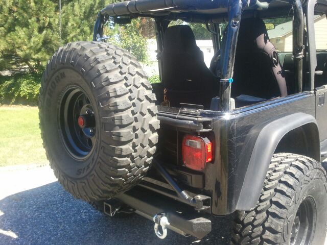

3 years with my Bestop tub mounted carrying a 35" tire. No complaints after install, but the hardware included leaves something to be desired. I followed Unlimited04LJ's recommendation, and replaced all the nuts and bolts w/unpainted grade 8 before I installed it.
It's about as close to the tub as you can get for an oversize carrier.

If I remember right they highly recommend corner armor for install. As do most other tub mounted carriers. Sheet metal on jeeps is about as thick as a dime... I wouldnt trust it to hold anything.
My Bestop carrier.
I wish I went with TNT, but the Bestop has been holding strong with no real issues. I like that it looks like it could be OEM.
AEV thought it was good enough to put on their Diesel LJ with 37s.*best pic I could find*
