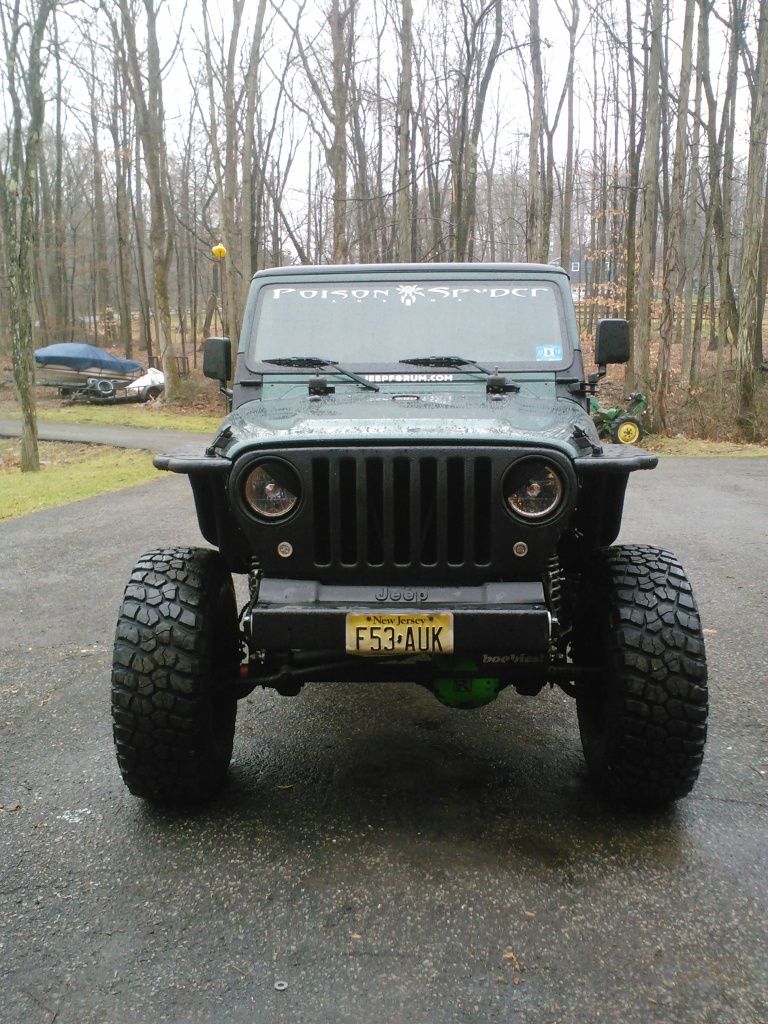

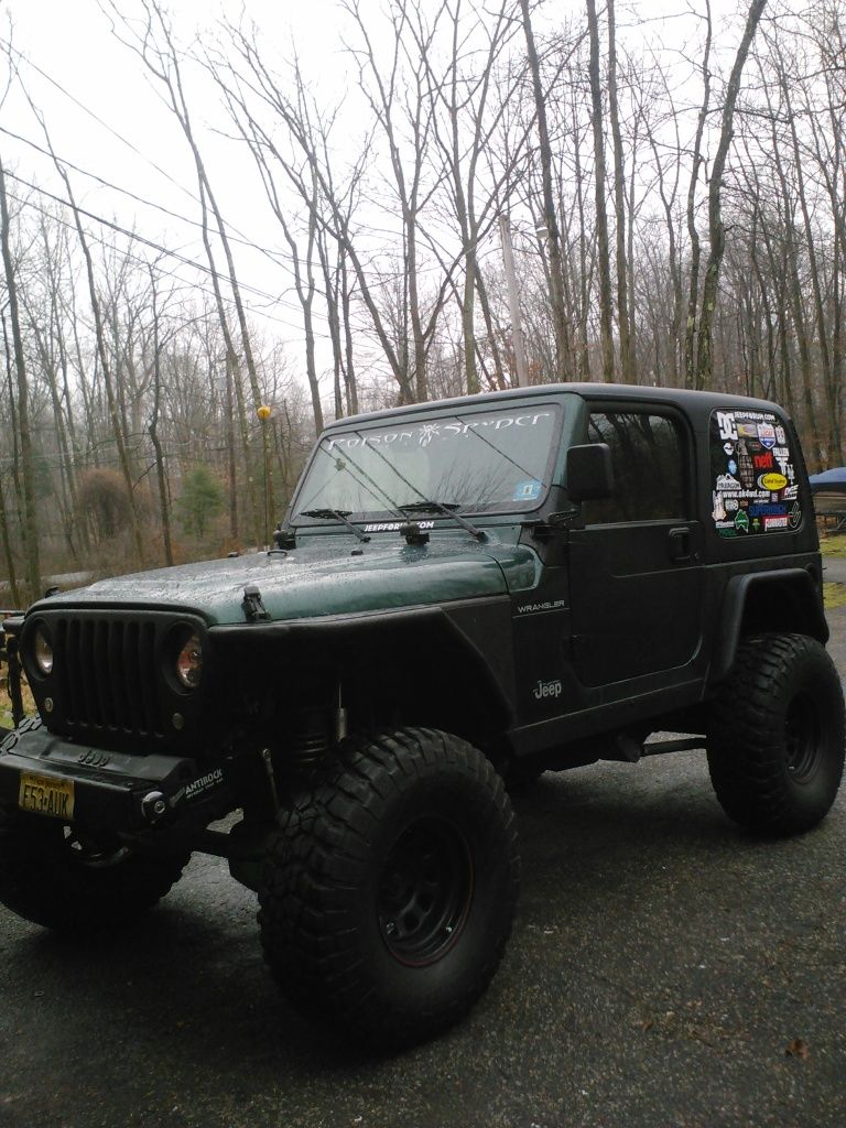

hahahah counter productive? Having a lower center of gravity and having fender clearance are 2 completely different things. I have the same fender clearance in the front as someone with 7" of lift BUT my jeep only sits 3.5" higher then a stock jeep.
I have 2.5" saggy coils(1" spacer to level the front) and 1" body lift on 35s, with highline fenders
