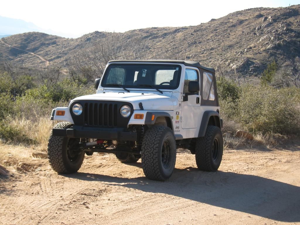

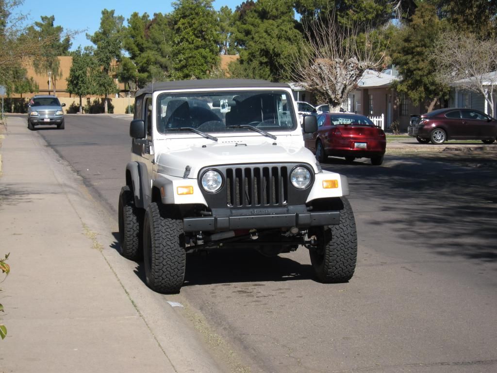

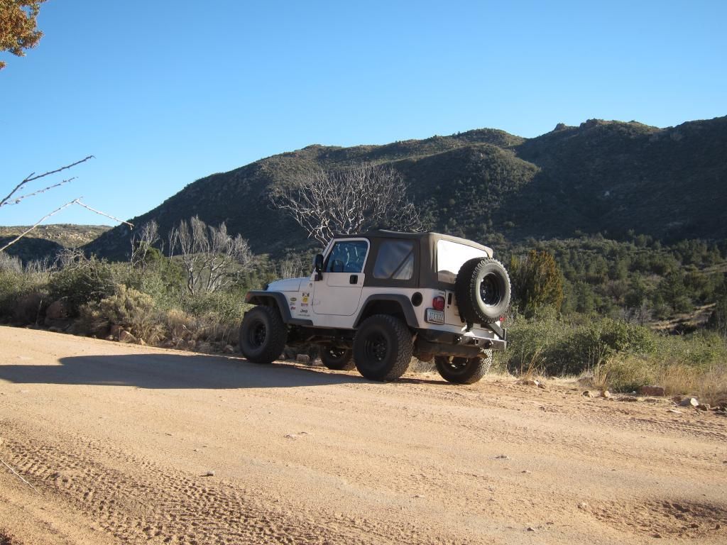

Here's back when I had just the Zone 3" kit on with 33x12.50 BFG ATs. Most of the Zone stuff is gone now, apart from the front coils. Don't get Zone hydro shocks if you live in a hot climate, they lasted about 5 months lol.
As for the topic of driveline vibes, yeah I had them BAD with just the 3 inch lift AND the supplied t case drop kit. I actually had to use washers to lower it another half inch to make it drivable. Needless to say I installed in SYE as soon as I could.
