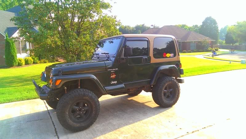

3" BDS with 1.25" BL on 33x12.5x15 Duratracs. I had to scrounge for some pictures so these are the best I have.
-Jack
BamaJeepman21 is offline
