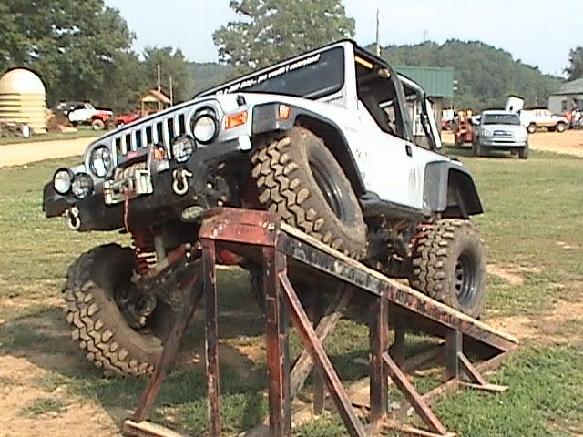

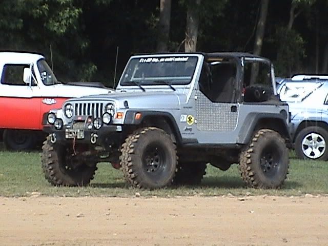

37" BFG Krawlers on a 4.5" RE long arm kit. pics are not mine, but belong to a guy in my club. he's running a stock d44 rear with alloy shafts, and a custom built d44 front from an 81 wagoneer. running 5.38 gears and lockers f/r. oh yeah... and it's his daily driver.

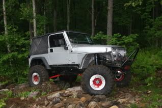

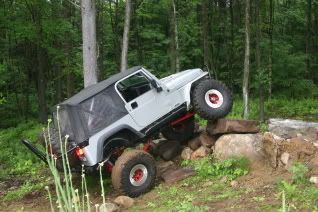

37" Super Swamper IROK's, 5.5" RK coils in rear, 14" Fox Coilovers in Front, HP60 (35 spline) w/ 4.56 & detroit in rear, Custom Hybrid HP9" (31 spline chromoly) w/ 4.56 & detroit in front.

wow nice rig. how do you like that set up? I kinda have the feeling that going with 37s and up with stock wheel base will make a tj way to tippy. maybe wider axles and rims maybe.
nice jeep though freggin awesome!

Thanks Actually the Jeep is really stable but I also cut both of the axles at 66" so it is about 6" wider than a stock TJ which helps with the stability.

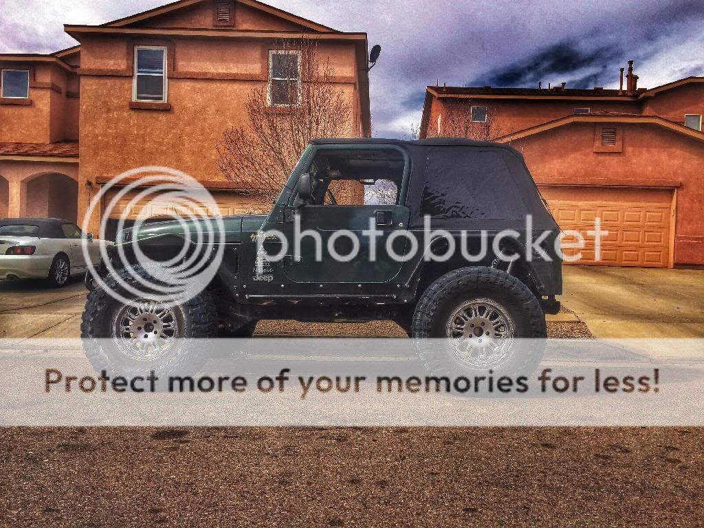

Old thread revival! Hahaha Technically a 1.75" lift. Just a 3/4 spacer rear (to compensate for the tire carrier that isn't on at the moment) and a 1.25" body lift.

Phenomenal. What rims are those if you don't mind me asking?

Thanks man. And...I don't know. Hahaha
