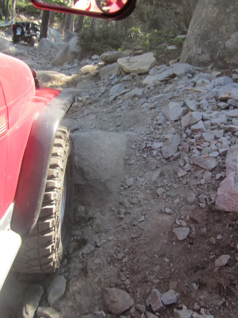

ive ran 35x12.50-15 on 4" BS rims with aftermarket CA's and rubbed slightly on full turns . i went with 36x13.50-15 with 3.75 bs and didnt rub
3.75 with 36x13.50's 6"wide rear flare , stock front flare
this is 35x12.50's with 4"bs 6" flares
