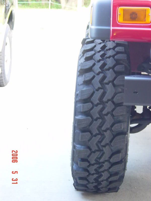

Tire width, wheel width, backspacing, and type of flares all come into play. Many variables
33x12.5x15 on 15x8 steel with 3.75 backspace and stock TJ flares.
35x12.5x15 on 15x8 alloy with 4" backspace. Trimmed stock TJ rear flares, MCE Flatties fronts w/3" flares.
