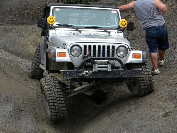

I'm pretty much maxed out here on my 4.5" RE superflex...not sure what exactly is limiting me, either the shocks or my currie antirock.
Checking my bumpstops...all good

Apex--looking good man. I'm guessing the shocks are stopping you there.
Thanks, guess I need to do a taller shock mount in the front now too

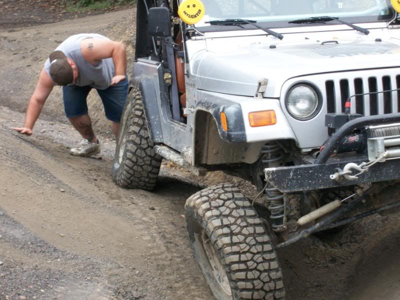

Some pics of the rear setup:
Some pictures of the front when I was droop testing. See the shock mount limiting the lower control arm from drooping anymore? I'm going to notch that to give the arm some more room. That's a limit.

apex, if you have the RE standard trackbar - thats whats limiting your flex - i have the same one.
after that though the limit is the shock brackets that imped is talking aboot
