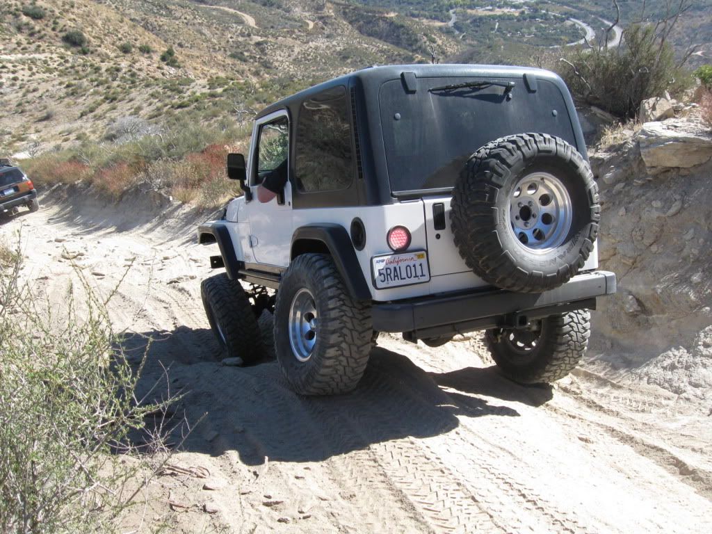

Imped very nice setup.. it's hard to tell who has the most flex in this thread.. Really for the budget lifts and I mean that in the most endearing sense of the word.. I think you'd be hard pressed to find a rig that out performs these Jeeps off road. Feelin pretty solid about the short arm choice

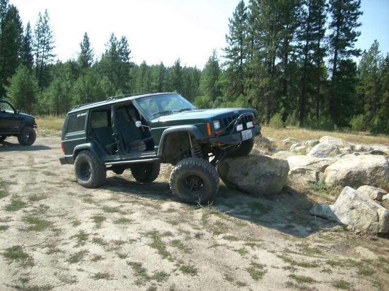

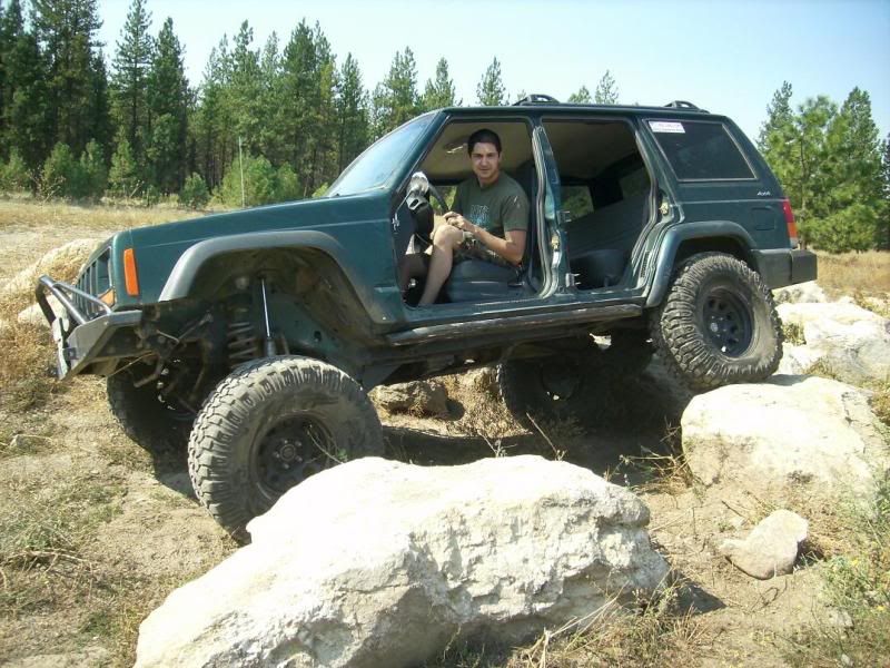

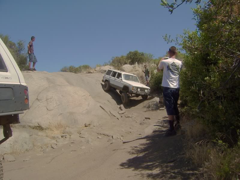

I think short arms kits are just as good offroad if not better in some situations. The only advantage of long arms I see is a better ride on the road. I never seem to have my camera with me when I'm actually wheelin but here are some poser pics.
lmao Jeeping where being a poser is praised!! lol VERY nice kit and really it's looking like these short arm Kits really are just incredible with what your jeeps are doing.

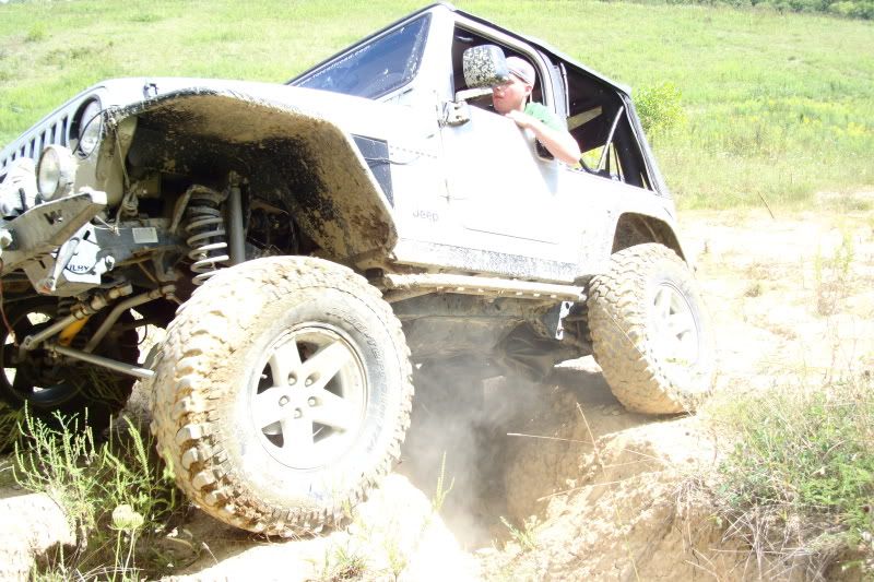

Some pictures of the front when I was droop testing. See the shock mount limiting the lower control arm from drooping anymore? I'm going to notch that to give the arm some more room. That's a limit.
Yes, still short arms, just no track bar. Currie lowers, Rock Krawler triangulated uppers, and no track bar. The rear axle is obviously trussed and that's where the upper arms bolt to the axle. I love the setup. It droops effortlessly with no bind points. Another great thing about the setup is that the pinion angle remains about the same through the entire suspension cycle so u joint binding is not an issue until really extreme droopage is reached.
