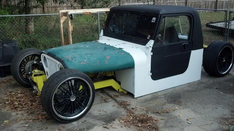

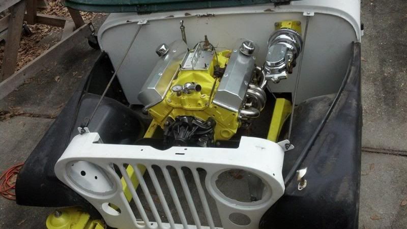

between moving and winter/holidays i havnt been getting much work but heres my little update
i lowered the frame infront of the firewall down alittle to get the crossmember to lay like the frame does, i also stretched it 3" and widened it 6"overall(had 2" spacers on each side before.)
also removed the motor mounts and build a motor plate
also worked on installing fenders, got the insides trimmed to fit, still need to do the outsides to follow the hoodline to clear the tires but want to get the cowl hood finished so i dont have to cut the fenders twice

Smebyspeed what is your hard top from? is it a CJ8 Scrambler top or something custom? Looks good. Too many ideas...

Looks custom.

it was an 88 yj with a hard top, i shortened everything to match then put a 78 CJ front end on it
