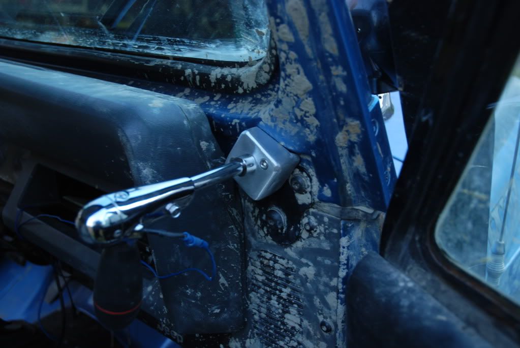

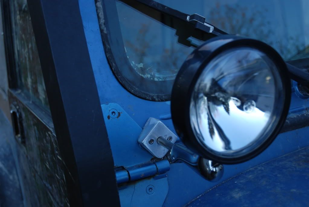

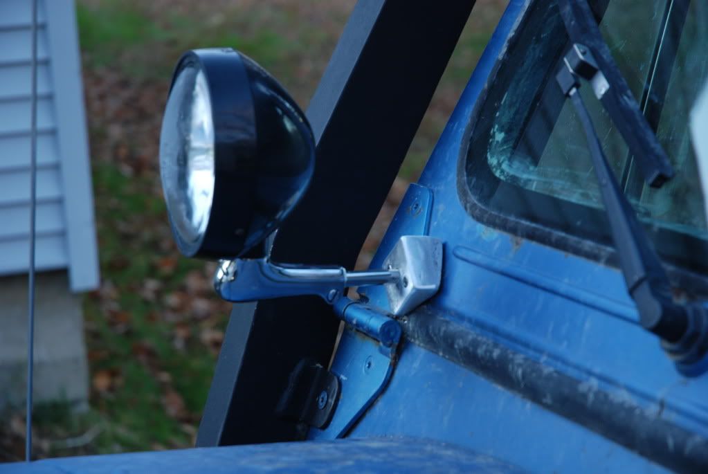

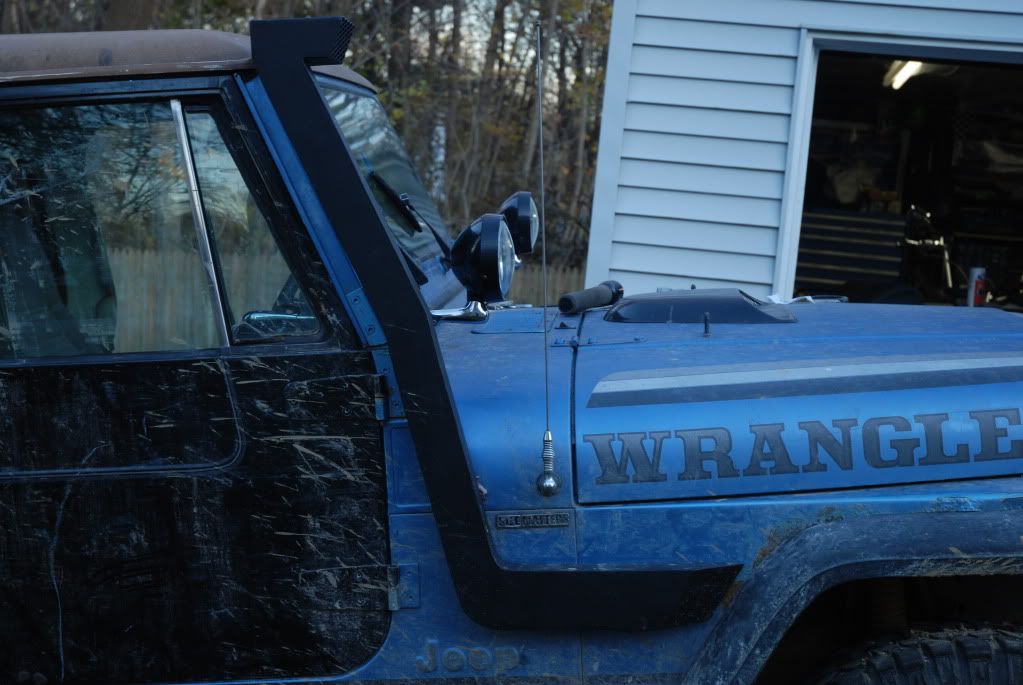

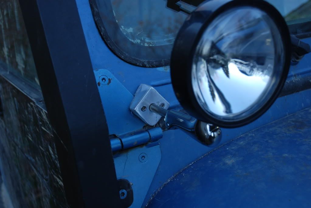

oh, I got them on ebay, the quality is like brand new. It cost me something like 60 bucks for the pair, they just strip them off crown vic's and sell them next to nothing, they're the same ones that cost $250 new though. I should have taken pictures at night too, I was surprised how well they worked.

how was the install? easy to cut into the sheet metal in that area? i want to do this on my tj really bad

The entire install was really easy but it took me probably 6 hours because I am a perfectionist and really didn't have all the right tools for the job. I actually plan to take the aluminum blocks off another day and make them completely flush with the window frame. the other thing that made it take so long was that I wanted to aim them so they would point straight ahead without having to tilt it sideways so getting the right angle took a little longer too. If you do install some let me know because I'd love to see how it went. I tried researching it for a while and never really came up with any results so I'm curious how other people would do it.

They hold just fine, no problem with movement. the lights I bought can only tilt about 90 degrees side to side and it stops it from twisting the outside sleeve just like it is supposed to (kinda hard to explain if you dont know what I'm talking about). Basically, it works just like it would in a police car.

I hear ya on that one. Figuring out where I wanted to put them was one of the hardest parts for me. I'd suggest you actually reverse the bracket and mount it on the inside and make a simple bracket on the outside (sheet metal and 2 screws and some silicon caulk). Doing that will keep the light closer to the windshield on the outside which makes it less likely to snag something and break, plus I thought it looked weird sticking out so far. By doing this, you will also have the handle stick in farther in the cab, clearing your hand from the dashboard and making mobility a lot easier.
