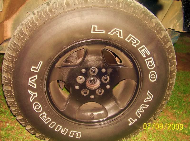

no before pictures but theyre just painted with gloss black cheapo walmart spray paint

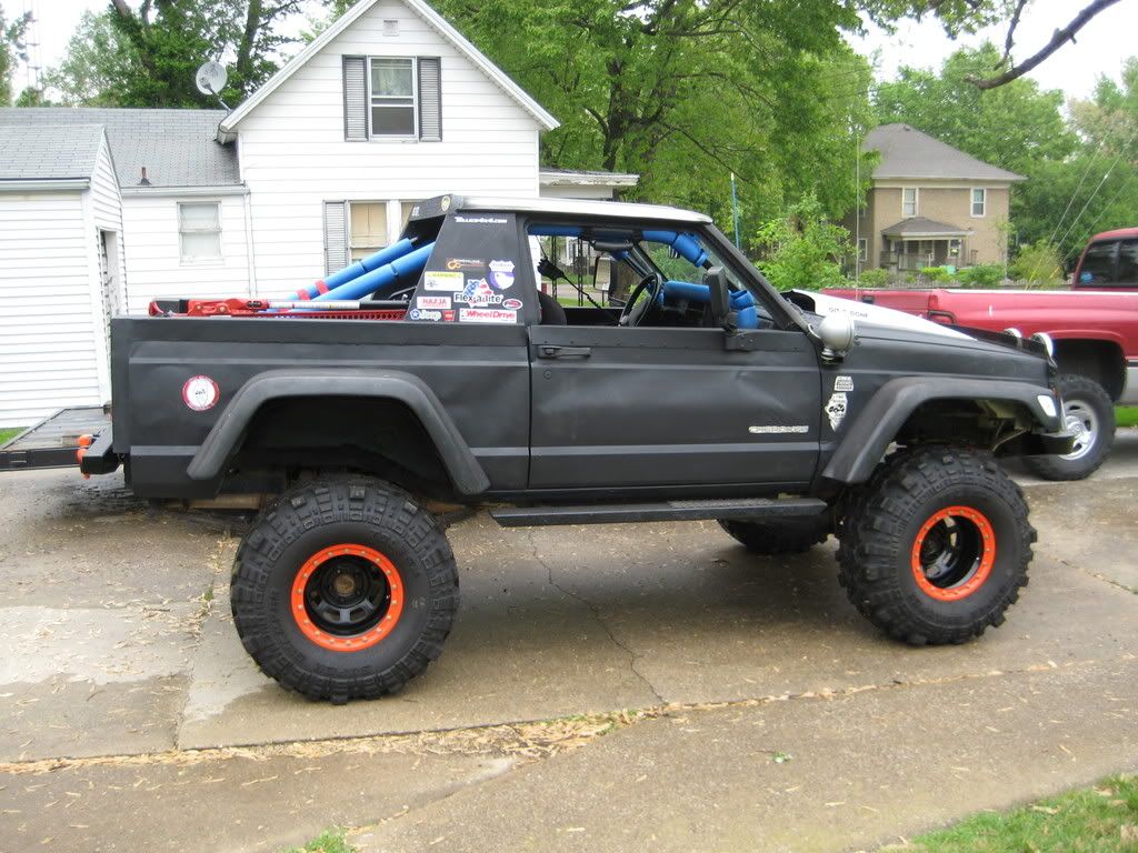

I didn't get any pics of these wheels before paint but they were nasty rusted chrome MRT Daytona 10/15 18 bolt true beadlocks.Bought the whole set of 5 off ebay for $300 shipped.Had the rings powdercoated "farmer orange" for $25.The rims I painted with plain ole gloss black rustoleum right over the chrome.About $10 in rattle cans.Got $335 in a set of 5,when new ones are about $250 a piece!

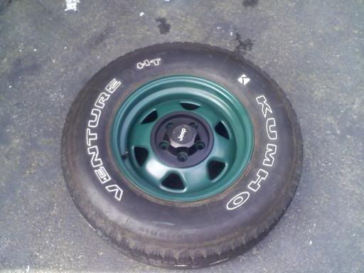

painted a spare wheel i had sitting in the garage.
[IMG][/IMG]

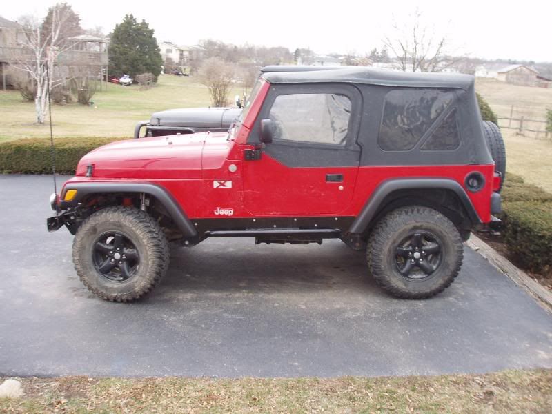

I painted mine the other day. I used Krylon Fusion satin black and it looks really good. All I did was pulled the wheels off, scuffed them up a bit, then painted several coats of paint. The paint has held up well on my bumpers, plus, it's an easy fix to touch them up if they do get scratched. Let me know what you think.
[IMG][/IMG]
[IMG][/IMG]
You did an awesome job man. Are those wheels Eagle alloys?? Those are the wheels I have and after seeing these I may do that to mine.

I liked it be4 it was black.. I'd understand if they were all scuffed up and stained and all but those looked like perfectly clean Eagle alloys...
