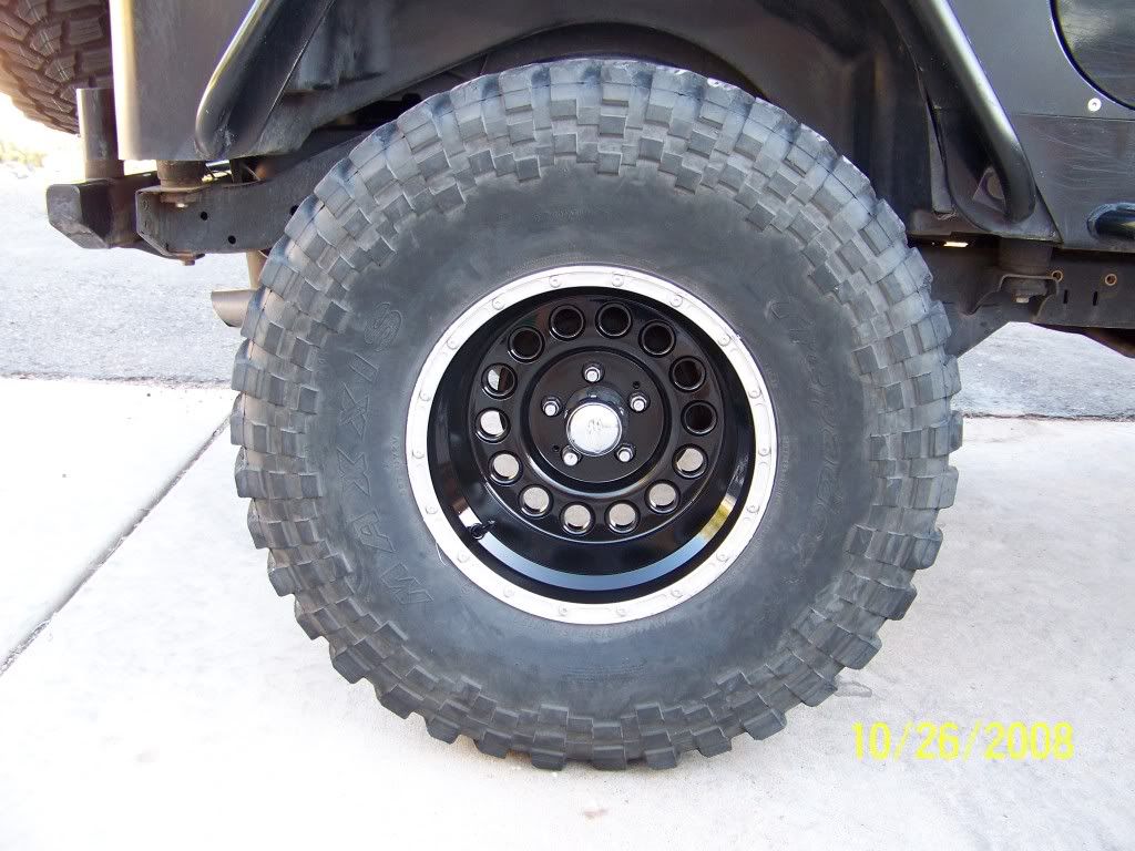

Originally Posted by azsCOOBY View Post
I used Rustoleum Professional Spray Gloss Black. 2 cans for 5 wheels. I sanded with 60 grit only cause thats all I had laying around at the time. No primer. I've had better luck with adhesion not using a primer. I did about 6 medium coats per wheel. I HIGHLY recommend the Pro paint versus the cheaper ones. You will definitely notice the difference
This is the paint I used for easy reference.

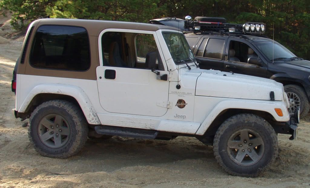

Hi everyone
digitalcox inspired me so i played with photoshop a bit. What do you think of darker rims on a white jeep?

Originally Posted by sgv209 View Post
Hi everyone
Looks a-ok to me
There is a girl around my area with a white sahara with dark steel wheels and it looks great.

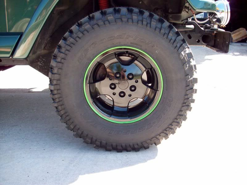

Here are a picture of my painted Canyons. They turned about pretty good I think!
BJ5781 is offline
post #26 of 141 Old 11-02-2008, 11:51 AM
allanmacaulay
Location: Myrtle Beach
Posts: 180
what did you use? how have they held up?
they look good

BJ5781
Location: Richmond, VA
Posts: 87
I cleaned them up really good then sanded them down with some fine grit sandpaper. Then cleaned off any dust and dirt from the sanding. Sprayed them with a couple coats of light primer. Once that dried I sprayed the edges of the rim with a couple coats of high temp green engine paint (don't remember the maker but it was a advanced auto parts). Let that dry then taped of the edge of the wheel that I wanted to remain green. Once everything was taped spray 4 or 5 coats of high temp semi gloss engine paint (black). Make sure you allow about 15 mins to dry between coats (**Note: I did this on a warm day so you may need to wait longer if its cool outside). Once the wheel was covered well with the black paint and dried I pulled the tape off and hit the wheels with 3 or 4 coats of clear coat. Biggest thing to remember is not to spray to closely to avoid running and allow enough time for everything to dry. I did this on a warm day and used a heat gun to help with some of the drying. Took me about 2 days total to complete and about $50 or $60 bucks for spray paint at local parts store. Also they have held up amazingly!!
