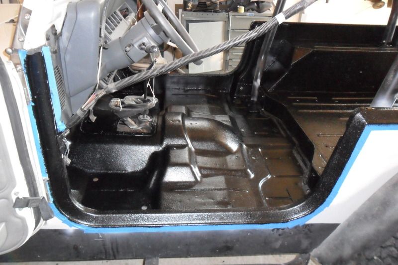

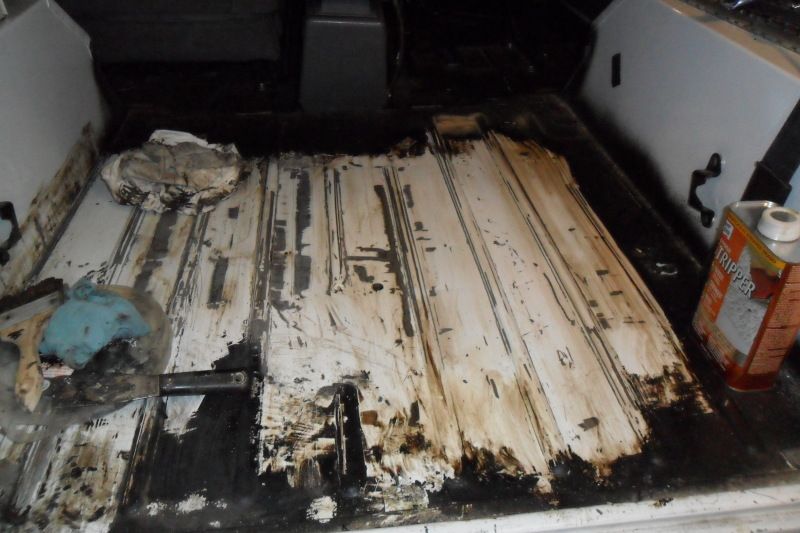

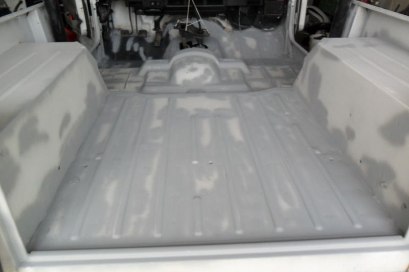

1990 YJ Interior. Black/rolled (exterior pictures in the very near future).
Sprayed on undercoating.
Removal process.
Primed and ready to Monstaline.
Finished picts.

damn that looks really really good

This looks great. Were you removing old bedliner or just paint?

Had to remove the undercoating then sand the original paint and prime. Paint remover worked the best to get the undecoating soft enough to scrape off with a paint sprayer.
