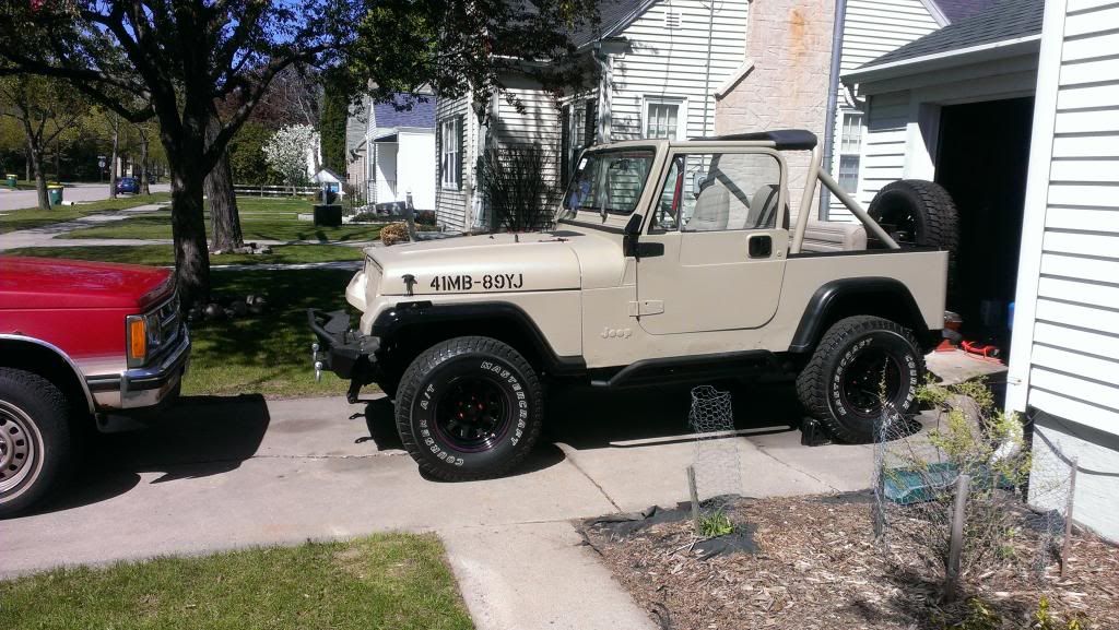

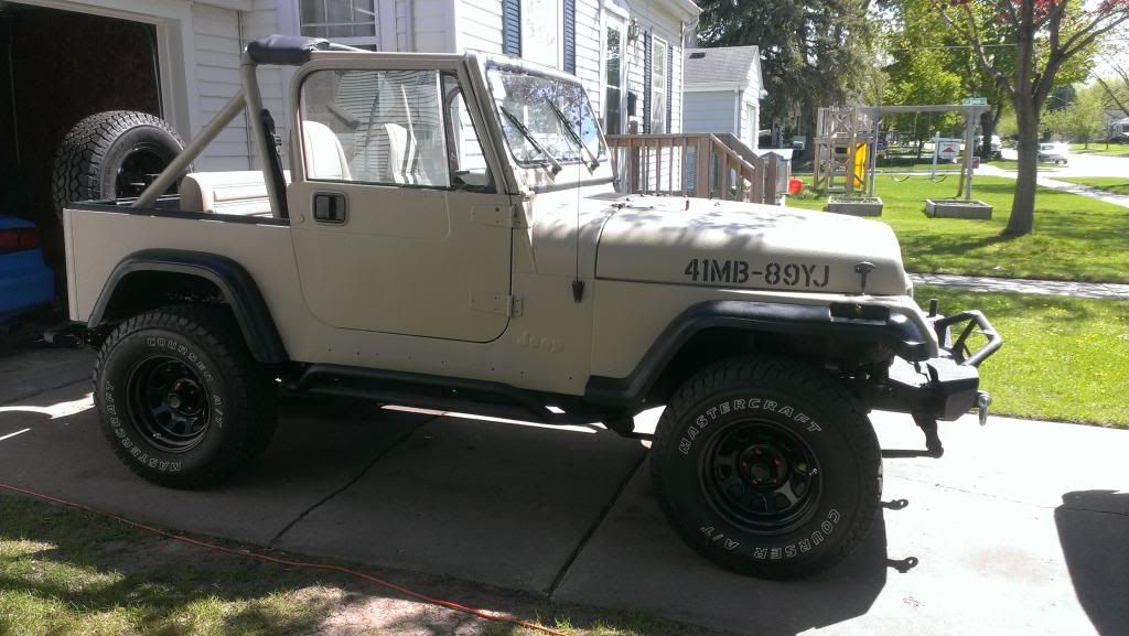

Originally Posted by rusty762 View Post
Love that color, is that desert sand?
Yes it is. [IMG][/IMG]
[IMG][/IMG]
