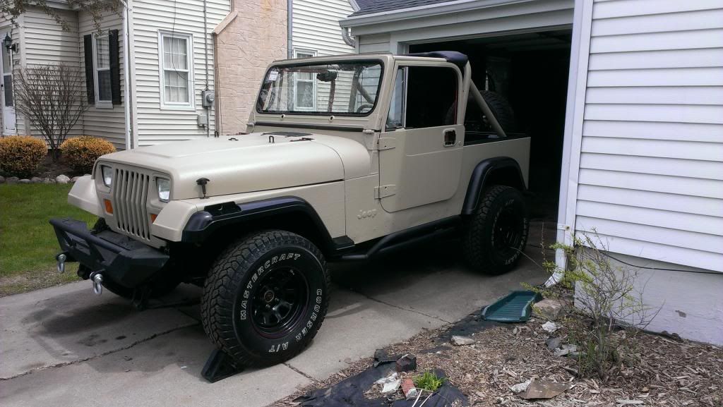

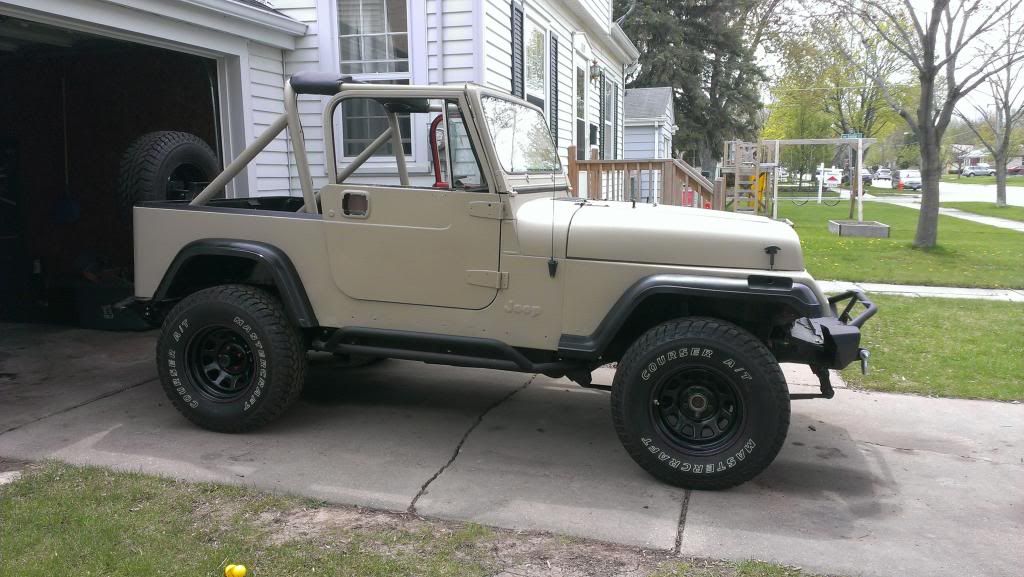

Posts: 60
just about done putting everything back together.
[IMG][/IMG]
[IMG][/IMG]
lordryan93gt is offline
post #717 of 1344 Old 05-20-2014, 10:14 AM
rusty762
Location: Monterey
Posts: 948
Originally Posted by lordryan93gt View Post
[IMG][/IMG]
[IMG][/IMG]
Love that color, is that desert sand?
