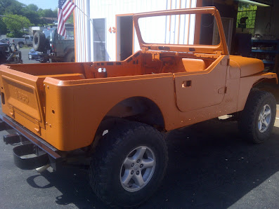

Dark Burnt Orange
It's still wet and in the bright sun. It should dry darker.
  • 3 gallons were used. I had about a quart left over. mixed about 2 oz MEK in each gallon when cleaning all the color from the DBTO can.
  • Sprayed with Walcom shutz gun at 70 psi (60 psi first coat) 5 turns out.
  • Had 2 cans to swap when empty.
  • 1 gallon did first coat. Second coat was sprayed heavier and used a gallon and a half.
  • I hit the floors, entries, and tail gate with some extra liner. Spraying heavy gives a larger, rounded texture. I did a light mist last to get the fine texture I desired.
  • By the time you get to the end of painting you'll get the idea of how you want it to be for your preference.
  • The whole inside of the tub, half doors, tail gate, roll bar, the whole outside of the body, and the front inner fender wells were all sprayed.
  • After I finished spraying and pushed it outside into the sun I found a few spots that needed touching up. I used a mini roller and sponge from the
    mini kit to take care of those spots.
