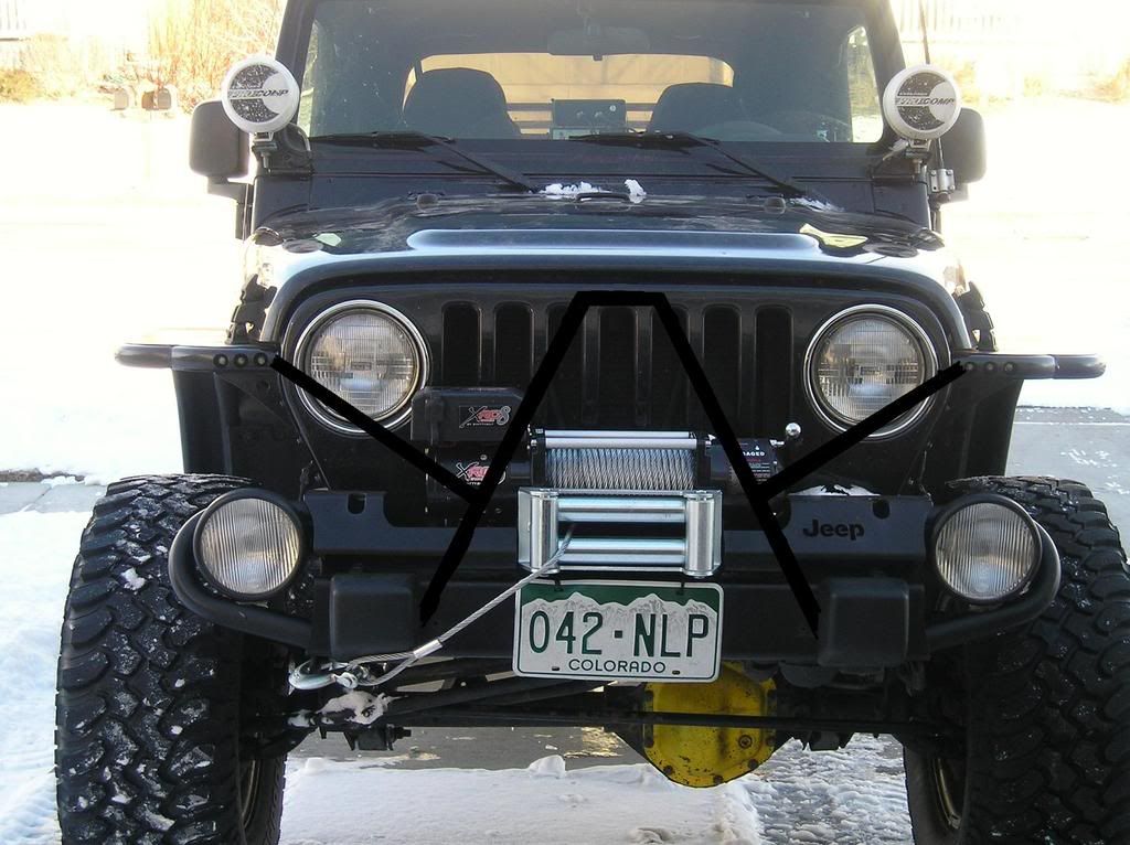

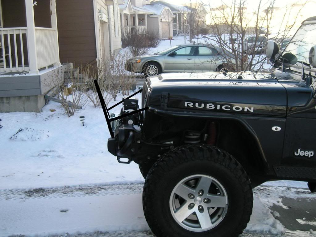

well, i posted a similar and nobody answered, so i played around in paintbrush and came up with these:
