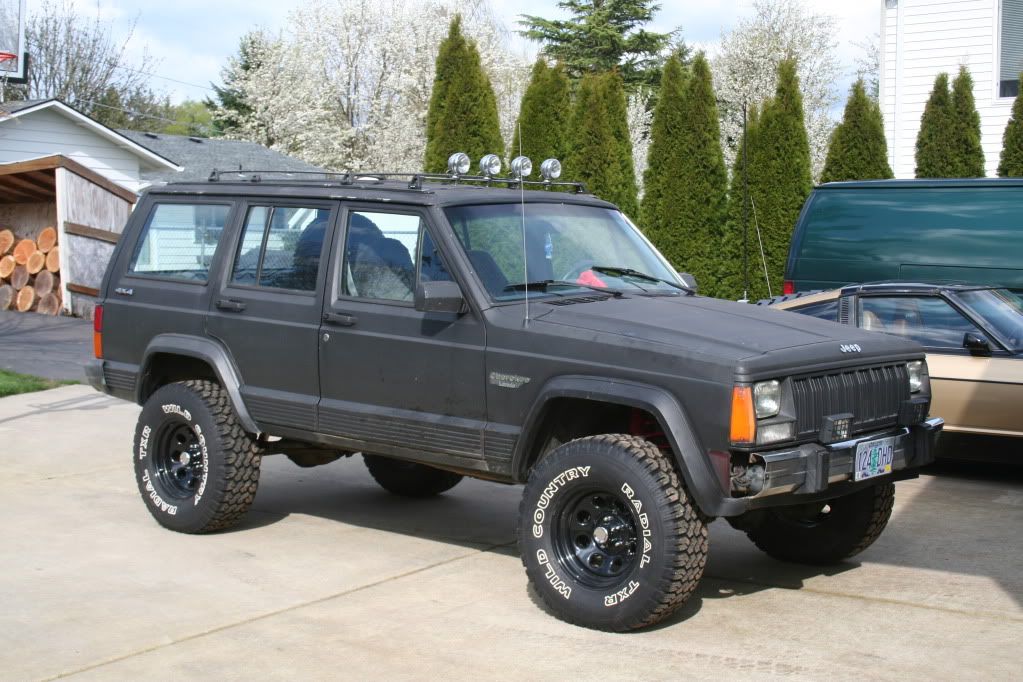

Back when I was getting started....Kinda sad I dont still have that hunk of ****
Mild info-Netted like 4.25in of lift dodge dakota bastard pack rear, skyjacker 3 1/2in lift springs from V8 ZJ with lower control arms. All pulled from a U-pull it

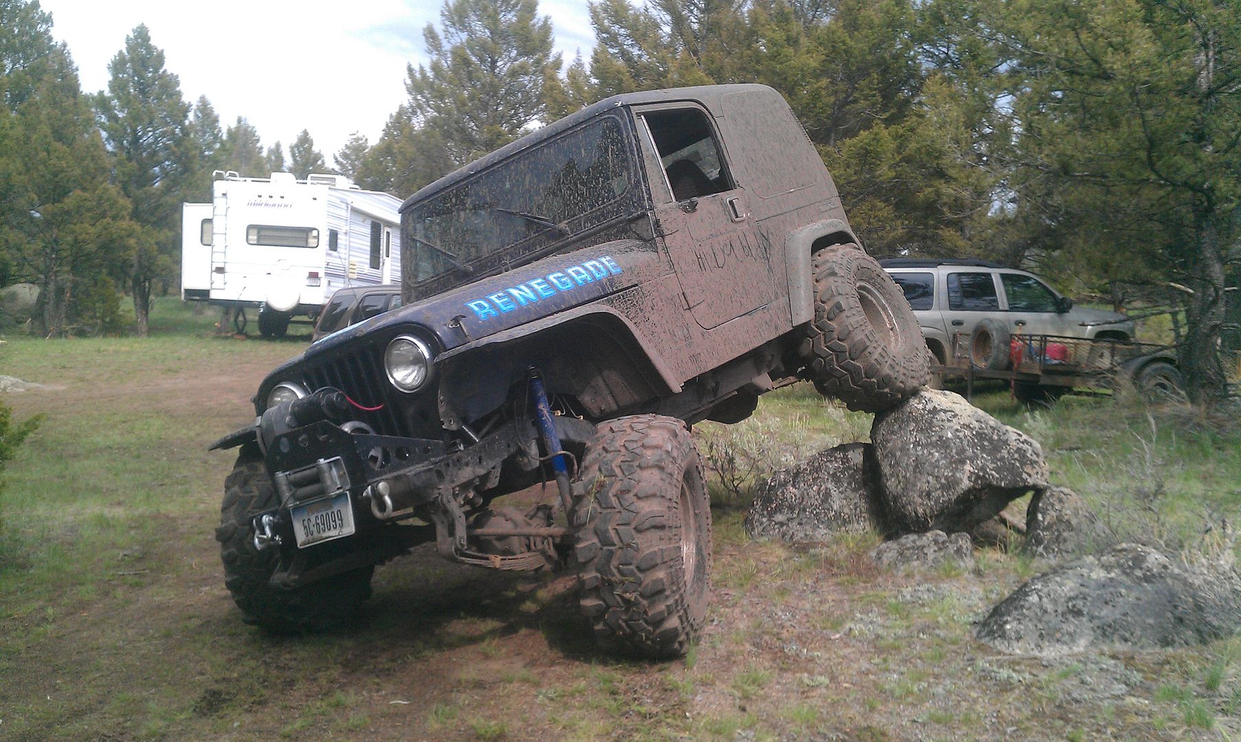

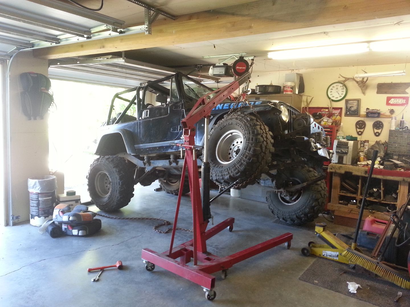

I'll play 80's grand wagoneer front leaf springs give 2" of lift 2" of stretch. Most everything on my jeep is a sourced from a junk yard swap or craigslist.
Flexes pretty nice too.

That's 2" of lift? That looks like more, and that's some damn impressive flex for SUA

No sorry that is 2" of springs 1" shackles and 1.25" body lift. I love the waggy springs they are the best budget lift for a yj you can find.
