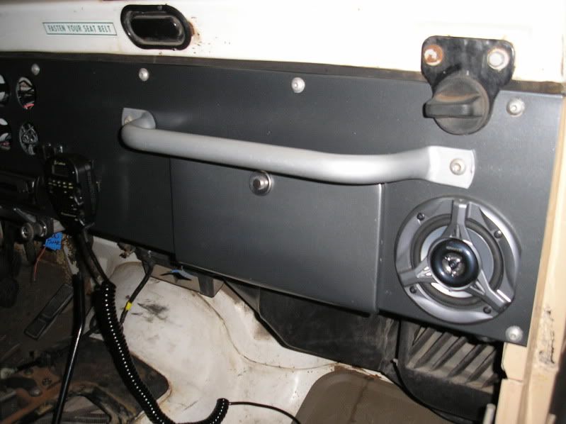

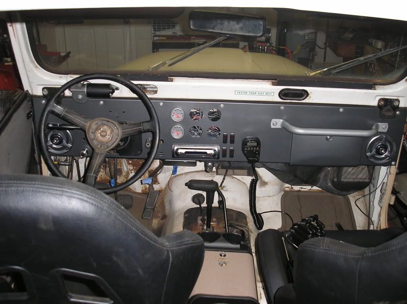

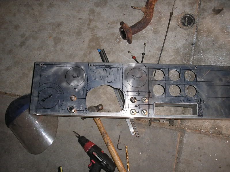

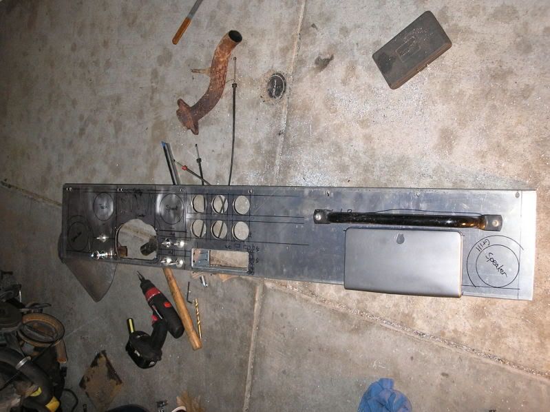

Mine was a piece of aluminum cut and bent the top and bottom 90's in it, then it was a bare scetch pad for me. I moved the glovebox over, center with the seat and put the speaker to the right of it. Then all the gauges and so on. Here is a pic of it not so complete. The tach and speedo holes still aren't cut yet. But you get the idea.....

Wow, looks great man! How much were the gauges? i see a few in on the last picture, they look really cool! also, i like the speaker idea, my wired front speakers are just my sound bar above.

All of my gauges are AutoMeter Ultra-Lites. They run about $30-60 for the 2 1/16" gauges.
I have fuel, volts, oil pressure, air pressure (OBA), trans temp, & water temp.
