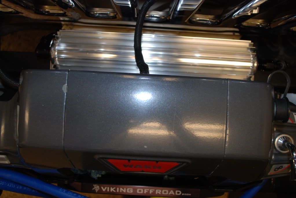

For any of you folks running hydro assist in a TJ, and using a cooler for the P/S fluid, I like to see how you mounted the cooler.

http://
http://

Thanks guys. I have one similar to #686 Sahara. I'll have to see if I have enough room behind my winch. 686 - do you find it to be pretty effective there? tjdriver - I actually thought about mounting it to one of the grill support rods, and may end up doing that if it won't fit behind the winch. The driver inner fender would be good, except that I already have a wireless module for my winch and an ARB compressor there.

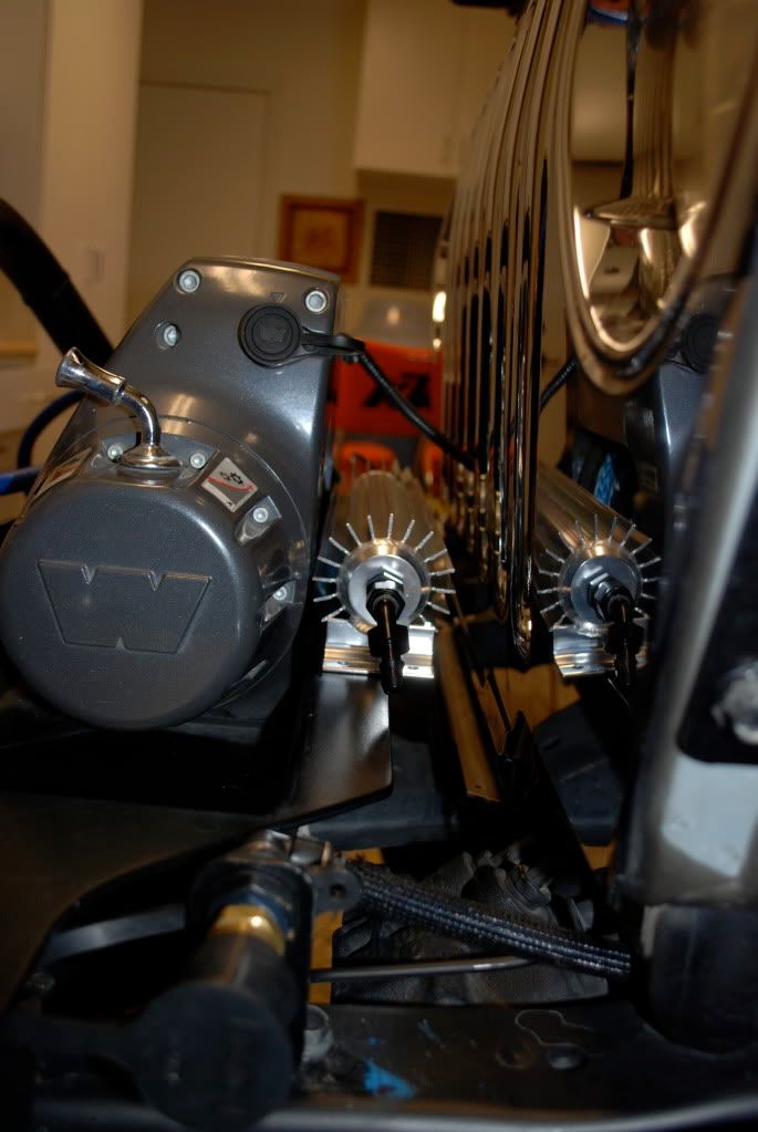

no hydro assist buti do have the cooler
Thanks for the pic. Did you relocate the wiper fluid reservoir or just eliminate it altogether? If relocated, where to?

My winch sits too far back toward the grille to mount it the way that #686 Sahara did. Checked that out tonight.
for now it is gone. im thinking of adding one of those bags like from the old time cars. jeep is not a DD so im not real worried about it right now
Yeah, mine either. I may just do what you did and remove the reservoir, and then figure something else out for that.
