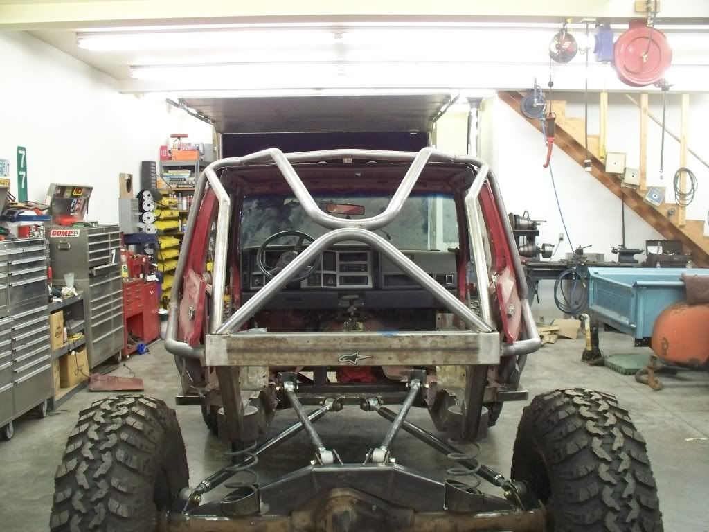

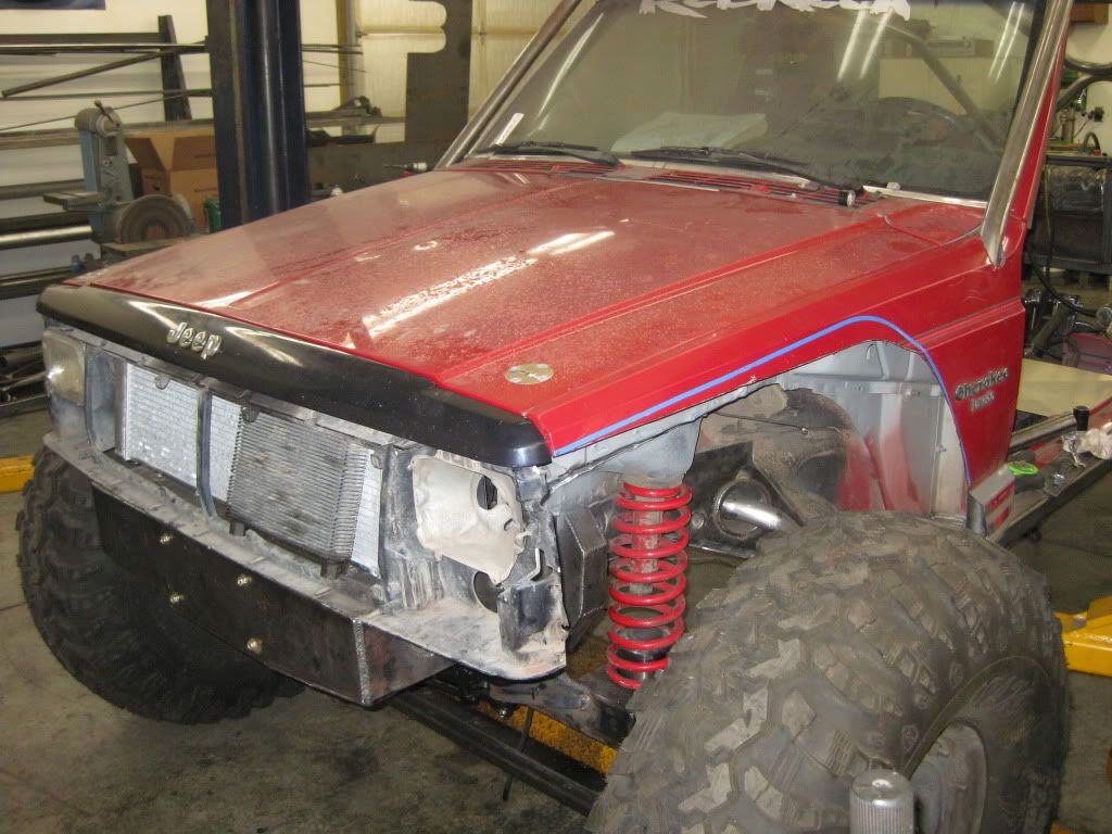

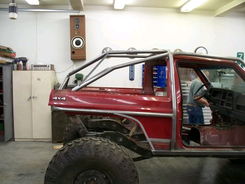

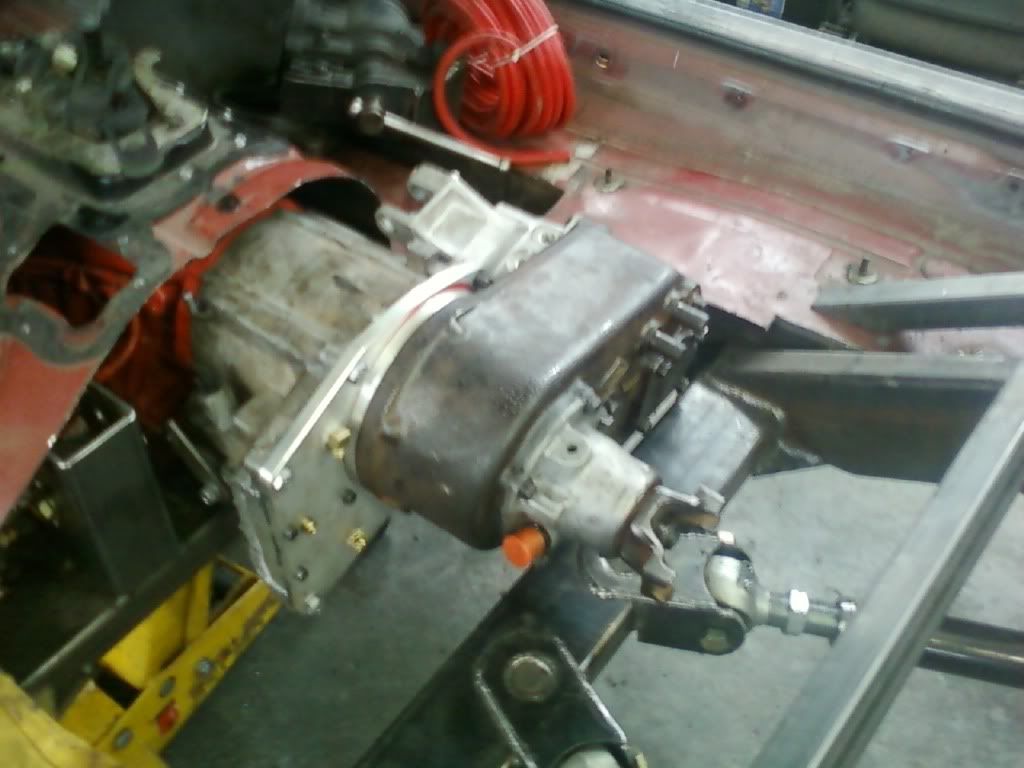

here's mine....
'91 2 door XJ
4.0
AW4
231/300 doubler
dana 60 front, 3link
dana 70HD rear, 4 link
full hydro steering
40" IROKs
crappy pics, no overall... just what i was doing at the time

In short, that's a sick *** XJ buggy.

Those rear springs WAY too short for such nice LAs
She looks great though, college project?
thank you
im using stock XJ front coils in the rear now.. the coils in those pics are nissan pathfinder rear coils..
and umm... what are LAs??
and yes.. college project.. associates in welding and metal fab and almost done with a bachelors in business management...

LA's = long arms . I hope you know what your doing lol!!
