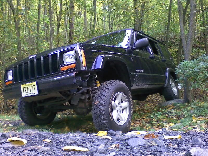

Ya I got some stuff done to it.

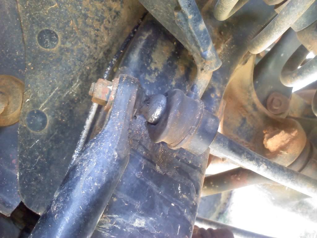

flexing at the house. think i broke where my sway bar connects. or will it pop out at a certain point in flex? i have no idea. any help?

no, that ball joint is broken, it's probably more cost effective of you to just buy new links in the form or quick disconnects, rough country has a set for like 60 or 70 bucks and I think the stock links are close to 40 bucks each.

so pretty much a good excuse to upgrade? lol

precisely!

thats def always the best way to look at the situation
