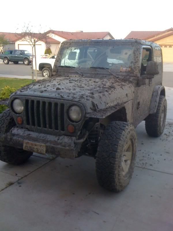

I cut mine and just filed the edges smooth. I would rather not spend the money for tubes when this gave me a bunch of clearance and was free. I trimmed the back of the wheel opening as well. it tucks 33's with only a 1.25" BL. These aren't the best pics, but you get the idea...
Later I may high line them, but only if I get a bit of suspension lift and bigger tires. I don't plan on bigger than 35"
Right after I did the cuts, testing the bumpstops.

I did the "trim the flare" thing too, and it just didn't look good enough IMO. I used a 90* die grinder with a 3" cutoff wheel. I left the fenders on when I cut them, just marked out my lines with 1/4" masking tape and went crazy. I did cut out behind the tire too. You can see where the inner fender line is different, I just followed that, and made a smooth transition. I'll see if I can get a pic of the area for better reference.

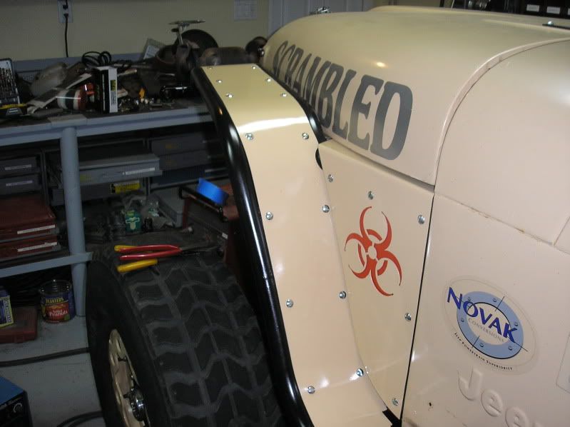

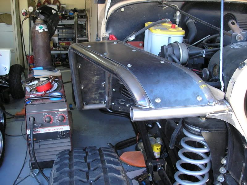

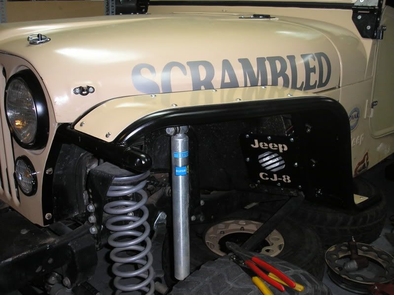

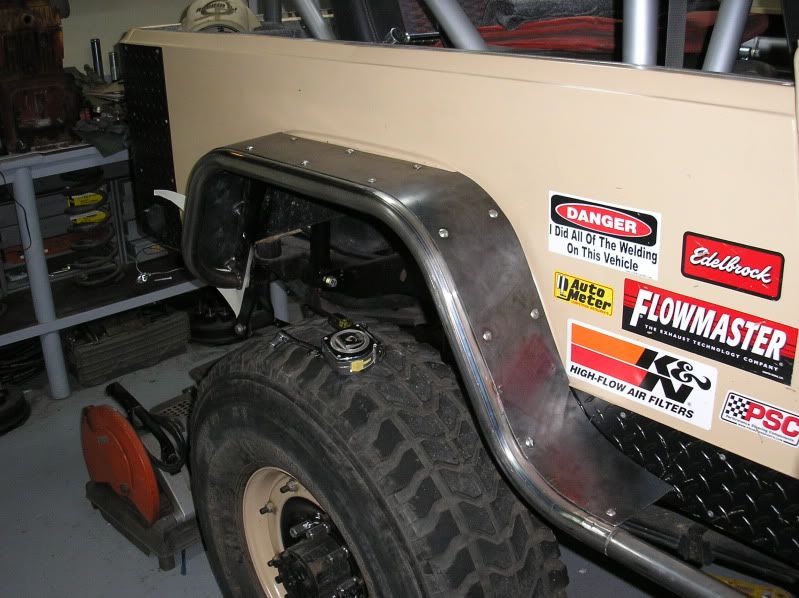

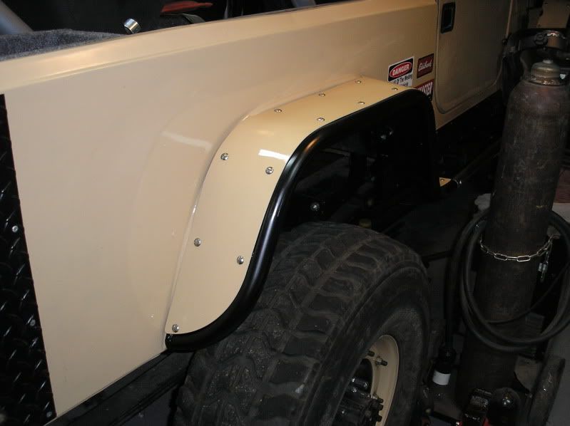

My wheel wells are still stock, but the tube fenders are all me:
Cameron Gunlock
