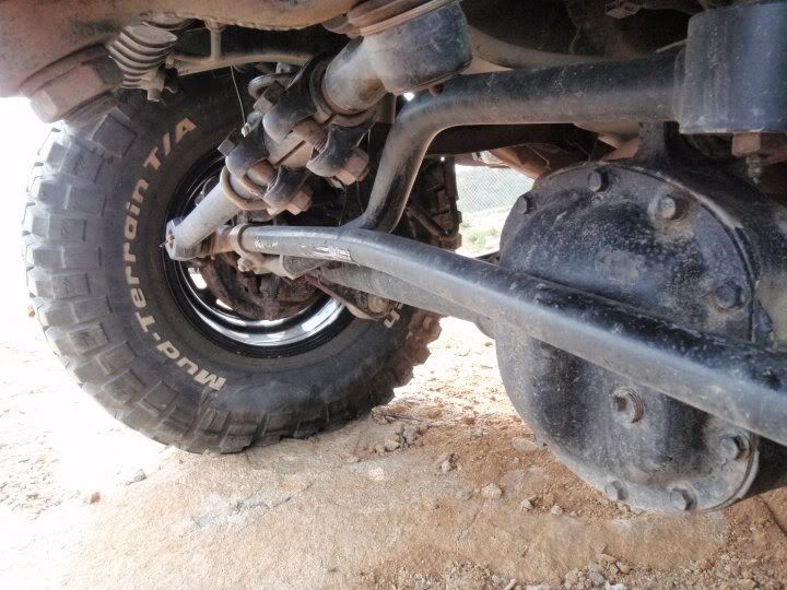

Here's the only pic I have of mine. lol. Other then this little mishap, it's been fantastic. When I first got it, I had an issue with one of the ball joints popping out. Went to Currie and they replaced it free on the spot (I had hit it very hard and I had an older joint. Totally did not expect them to replace it as I had abused it). This picture was taken after I decided to slip off one rock and face plant into another rock.
I recomend it to anyone with a lifted Jeep.

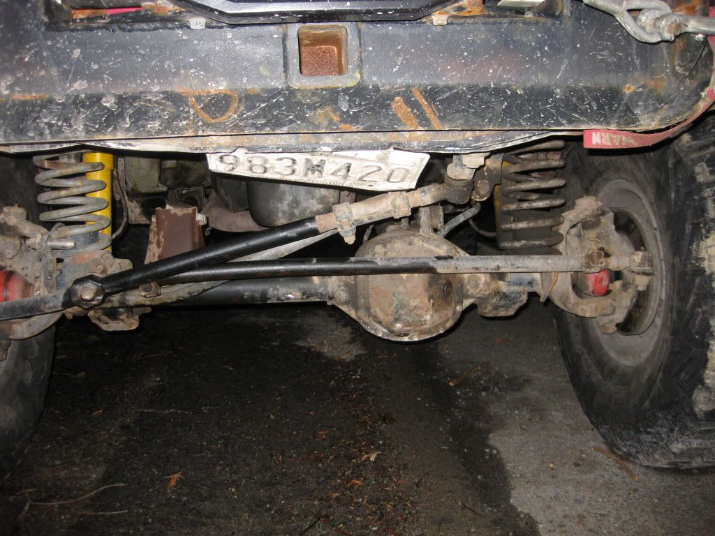

Here's mine with the tie rod flipped. It's bent pretty good, but I just adjust the toe every time I bend it and its been working fine. It's soo much higher with the flip, but with my axle pushed forward, I had to cut off the sway bar mounts and part of the coil bucket because the tie rod was hitting. Very beefy steering setup, has served me well for over two years of hard wheeling.
