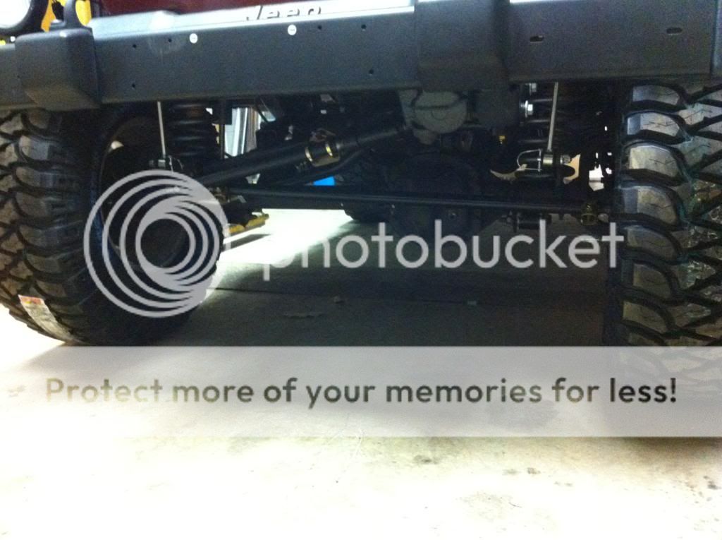

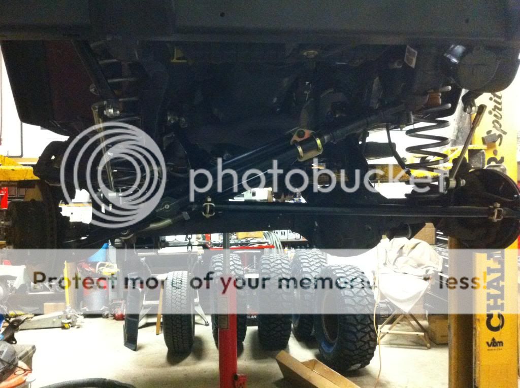

[IMG][/IMG]
[IMG][/IMG]
These things are massive and really nice pieces.
