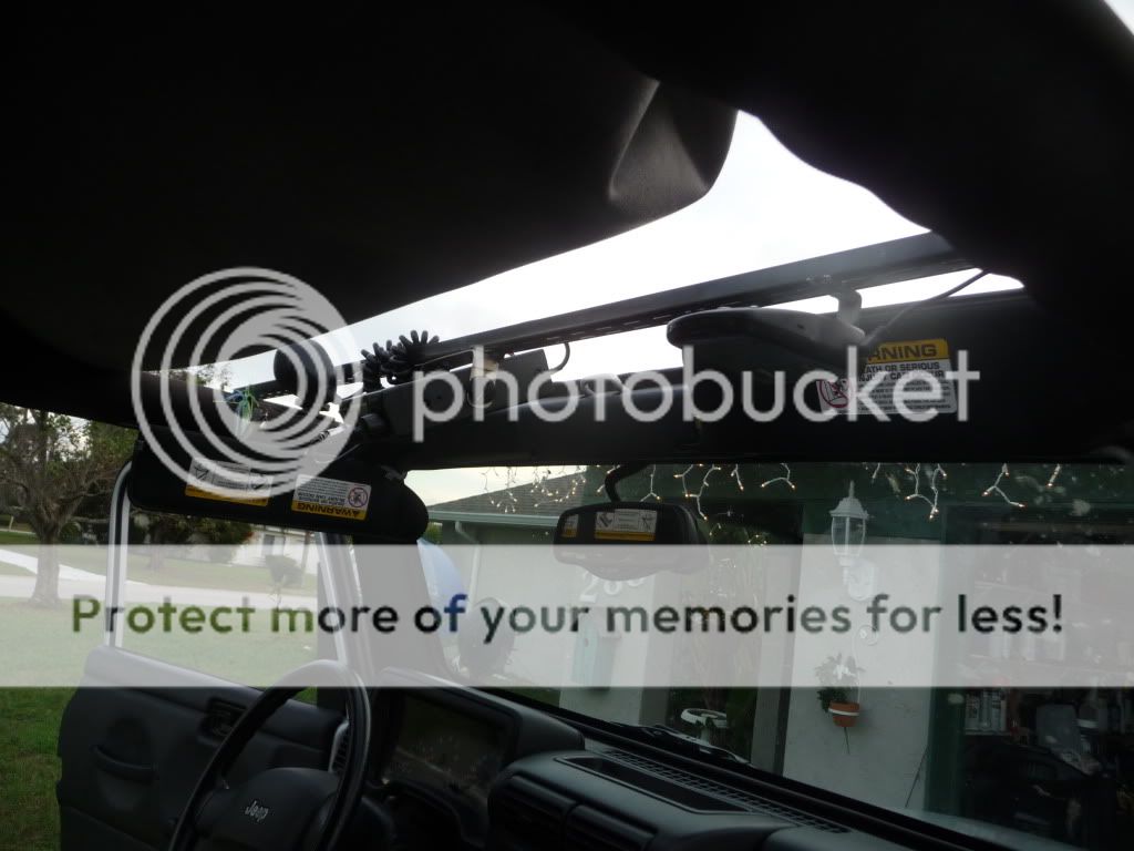

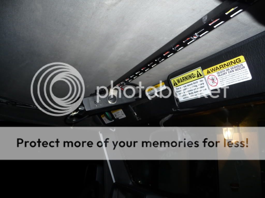

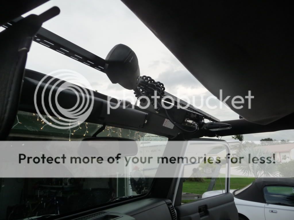

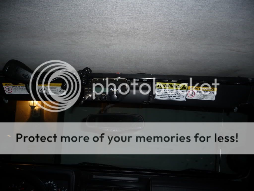

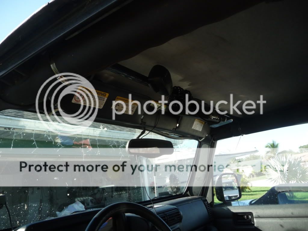

Went to Home Depot and bout shelf track for about 6 or 7 bucks. cut to fit over roll bars put hose clamp around roll bar through shelf track. I've made a couple changes to it but rack is still the same.
Run coax through roll bar padding to the back tail light and make an L bracket to mount antenna there. Or on the bumper.
2006 Jeep Wrangler Unlimited Rubicon 4.0 with a 6 speed hand shaker on 35's with 4" of lift. B.S.M.C.C.E.P.C. #86

BTW ran power down pass pillar into dash at fuse block with fuse tap, zip tie wires into rack and it looks pretty clean.
