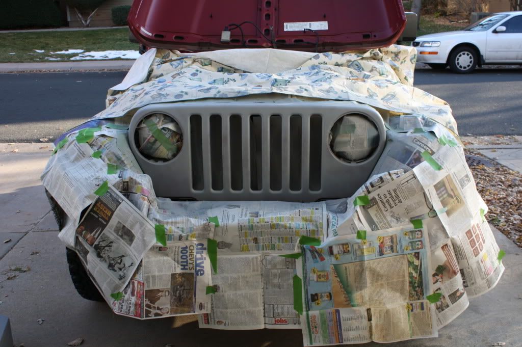

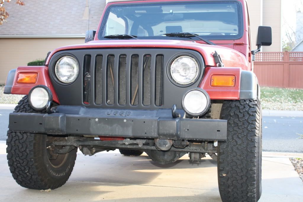

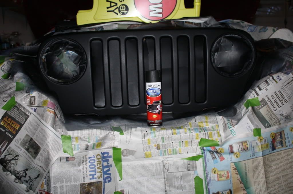

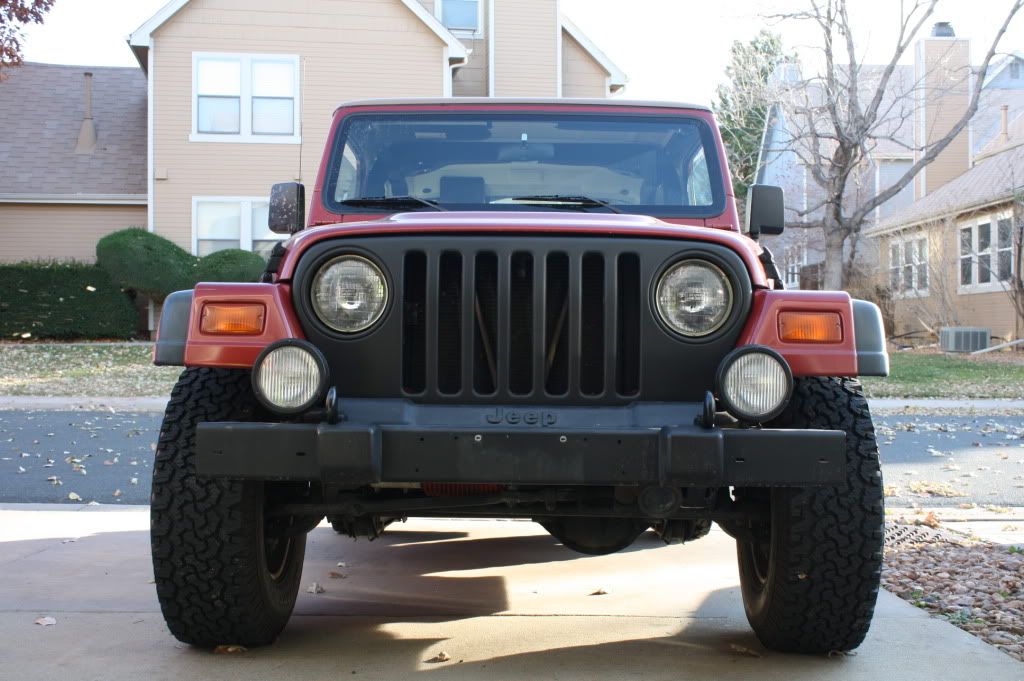

I finally took advantage of some nice weather and painted my grill
Came out great, I love the look. Also added some tow hooks.
Thanks for all the help, guys and gals. Next will be the bumbers and fender flares.

Thanks, I hit it with 2 coats of primer and 2 coats of bedliner. Im not much of a painter. I love the bedliner, the texture hides mistakes well. I painted my mirror brackets as well.
I did what coinpurse said to do. Just scuffed it with a red scotchbrite pad then wiped it down with mineral spirits then some soap and water. Taped it off and sprayed it.
