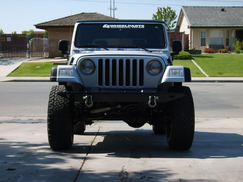

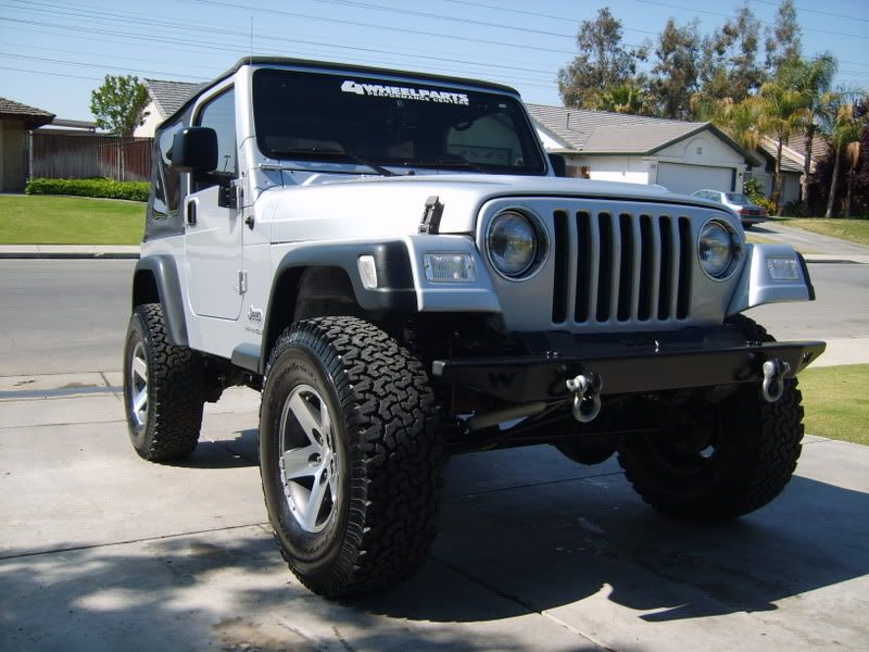

Ive got 285's on my TJ with Rubicon wheels. However, my picture page is down right now, so I will have to post later. If you want to know really bad, you can just do a search on my latest posts, and you will find pictures of my rig in there. I feel like ive been posting pics like crazy lately.

let me see if this works...
not the picture i wanted to post, but it will work for now

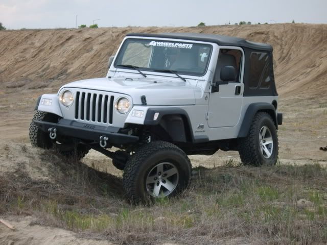

315/75/R16 Baja Claw on the factory Moab's. No spacers:
Really!? a 315/75/46 with no spacers? That equals a 35x12.5x16! I didn't think that would be possible. Do you get any rubbing on the spring perch or tie rods? Can you disco with that? I'm just really amazed I thougth 285/75-16 would be the biggest.

No sir, no rubbing. Keep in mind the Claws run a little small. They actually measure 34 inches tall.

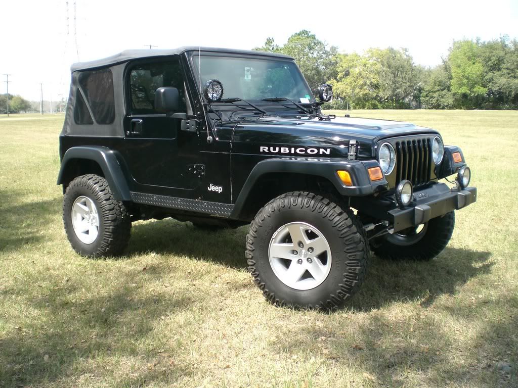

Stock Rubi wheels w/ 285 75 R16 Trxus MTs. No rubbing, no spacers, no washers.
Nice setup. That looks about perfect. How much lift do you have.
By the way. Thanks for the detailed info. Thats what I needed to know.

I would dare to say, it just depends on how much space you have under the fender. You could probably, like stated above, fit a 35x12.50 on em no problem. Heres a couple more of the 285's on em. I think the BS on the rubi wheels are amazing!
