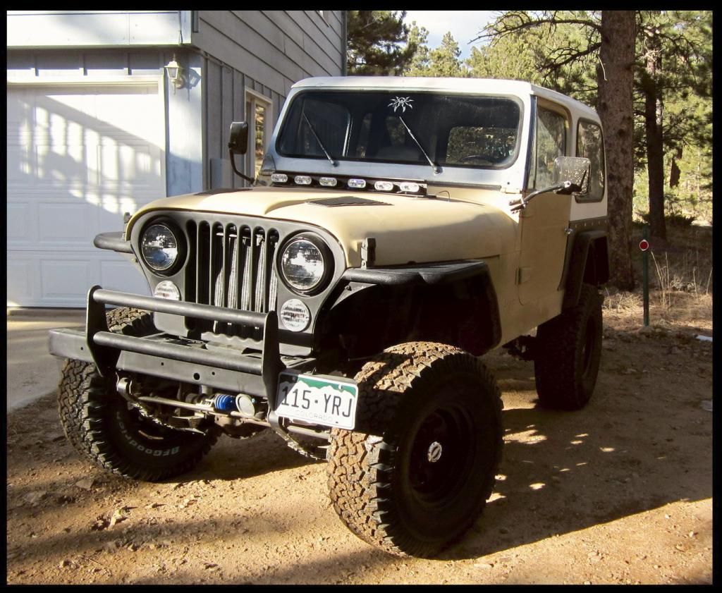

Posts: 188
I'm in the 12.50 camp. Running 33 X 12.50 X 15 on 8", Pro-Comp Series 98 Flat Black wheels with 3.75 Back spacing. I'm also running 2" Spydertrax wheel spacers all the way around. Comparing this to driving on stock wheels & tires, in a vehicle that is known to be squirrely, I'm very pleased with the greatly improved handling of this combo.
I'm retired now, but if this was a true daily driver, and considering that we're 33 miles each way to my old office and 50 each way to the airport, I may have dropped the width down just to lighten the load on my wallet due to the load on the CJ. However, living where we do and only doing mountain driving around the canyon in all kinds of weather, I love the 12.50's.

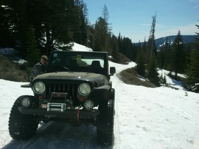

I'm running the BFGs in 33x10.50. I traded my friends 35x12.50s for a week and he took my 33s, he decided once he wears the 35s out he's going back down to 33x12.50. I liked my 33s better in the narrower form to get through the mud. We hit the river some and I have no problem in the sand aired down some. Big and wide look cool, but I'll stick with the shorter skinnys.
