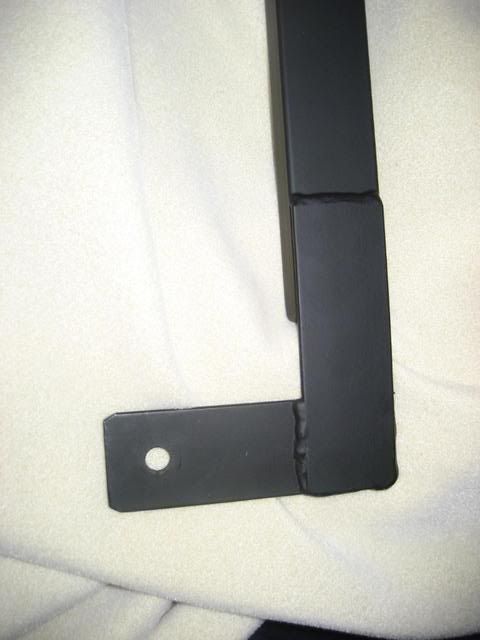

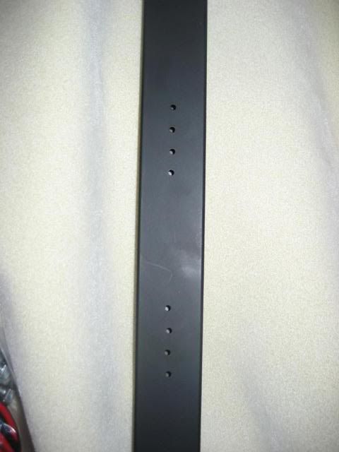

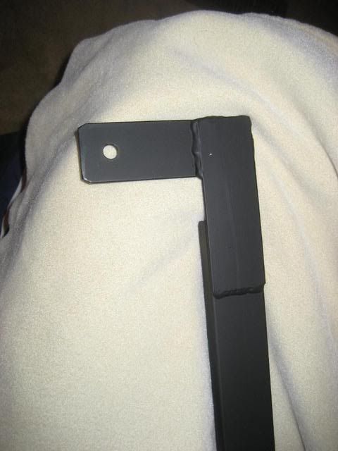

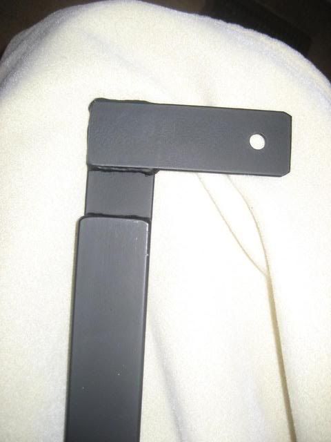

Here are some pictures of it before install...
Left top side
Left bottom side
Right top side
Right bottom side
Middle
Wire hole
Both ends are open to run wire + my hairy arm
Once it warms up i'll work on rewiring the inside so that I can mount this!

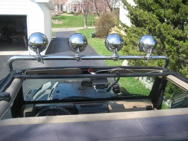

Update:
Got my new jeep and installed the ARR radio mount.. I used the door frame knobs as anchor points and let me tell you these knobs are very poorly designed, the M8 bolt shank is splined into the plastic knob and as soon as you apply some torque, the clamping load wil undo the splined joint..
I replaced these OEM knob bolts with a SS M8 (80mm long) and a SS fender washer.
Also once you use these mounting points, one might slot out the mounting bar holes.. This will allow clearance for the soft top front latches to operate fully extended..
Be sure you dry fit the radio's before making it permanent.. The sunvisors will define the location..
I wanted to install the mount bar as far forward as possible without any interference..
I will update this post with pictures once all is hooked up, including the two antennas..
