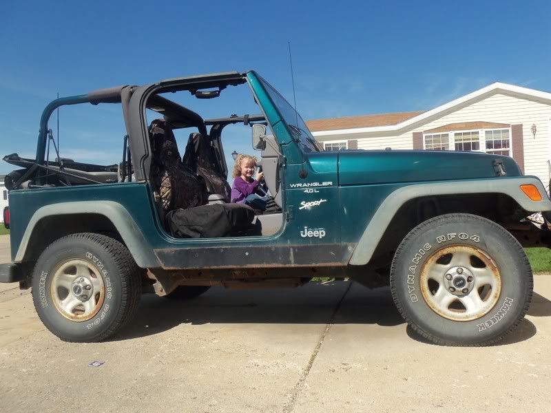

MY FRAME!!!! The lowest points of the frame. Also the same place the factory put clean out holes. If the previous owner did not use these holes, and they pack full of good ol' northern road salt, your frame will rust from the inside out, like mine did Also, on the frame, where the transfer skid mounts to the frame rails was pretty nasty. The tops of the front fenders on mine were shot, both had holes, about the size of a baseball. And on the bottom rear corners of the tub were starting to go. I think my 01 was worse than usual, but mechanically, it was great. I drove it for awhile, contemplated a frame swap ( I found one for next to nothing) then traded it for a boring 4 door family car that I needed in the first place. Next jeep, JK RUBICON

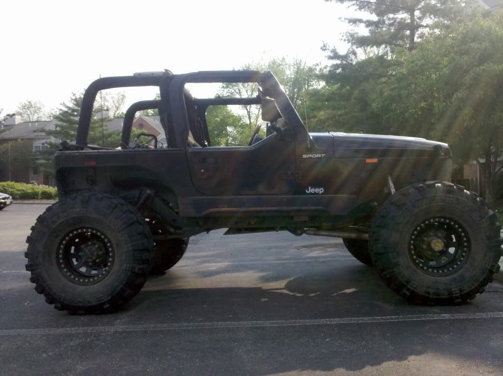

Man thats quite the beast youve got there flatlander! Nice job. After you spray water in the clean out holes, how does it drain? I have plenty of road junk that is just waiting for a good power washing. Ive heard that some guys drill holes in the bottom of the low points of the frame. Im thinking about going for it. Any thoughts? I also have two rust spots on the back of the body. Ill put some pics up later. It looks like some welds rusted out. I dont want to see my baby disintigrate
