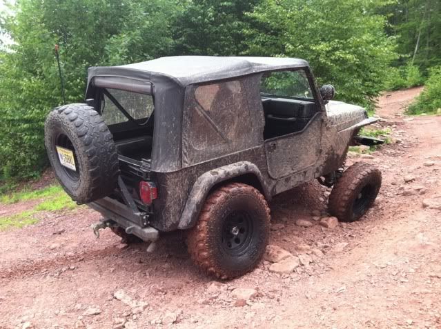

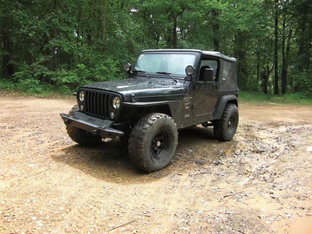

TJ before any lift on 33x12.5 tires:
TJ with 4" suspension lift on 33x12.5 tires:

Looks good Mirra, thanks for postin'! Must be pretty fun to drive the Jeep around with the same setup both stock and lifted, and really be able to tell the differences.

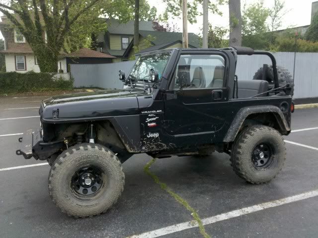

Moab last week. I love these fenders.

Awesome pics gspup, thanks for posting! What trail(s) are that in Moab? The first one looks like the entrance to Kane Creek?

Bingo it is Kane Creek. No pictures of the more difficult climb at the end, my passenger was busy spotting me.
Cool, fun trail!
