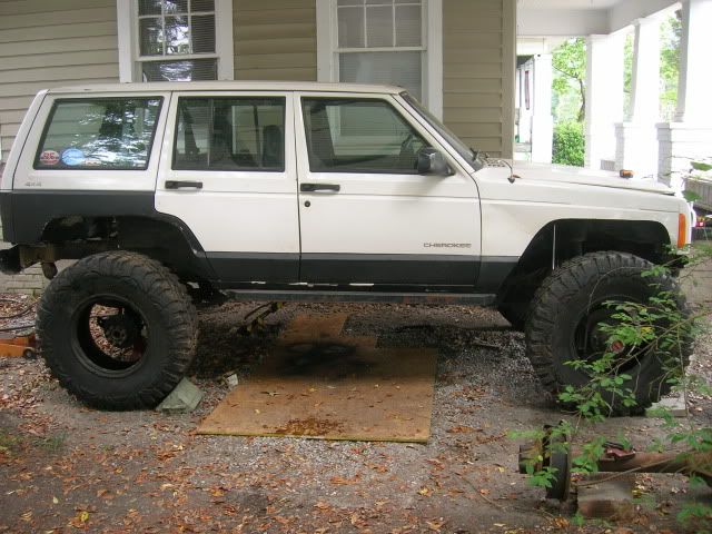

My work in progress... -6" lift (minus 6), about as low as i could get it on 1tons and 38.5 SXs. Could lower the rear a lot more but the front would be tough without going to a low steer or putting a relief in the frame.
79 CJ7 EFI401>th400>Atlas II 4.3> 60/14, 38.5 SX's, H1 beadlocks

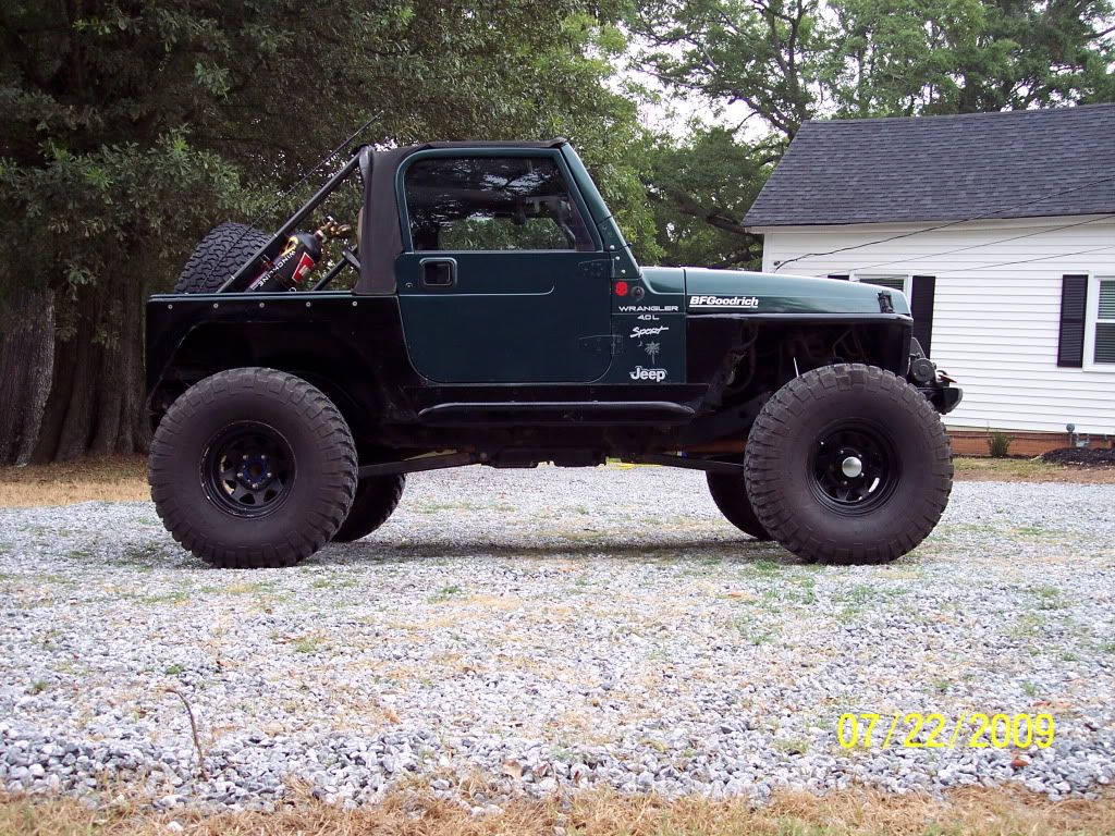

Around 3 inches. I cant go lower without backhalfing my frame. I am shooting for an inch lower with the belly up just a tad.
2001 jeep wrangler sport / Waggy 44 /FORD 8.8. lockright/ 4.88 / 3/2'' lift,Stretched to 100.5/ Warn x8000i / 35in BF KM2's / AtoZ rockers, cage,/ Poison spyder crusher corners.

looks good man

alex71, do you have a build thread? that is a nice rig

i do on a local forum
http://www.gatrailriders.com/GTRForu...p?topic=1431.0
