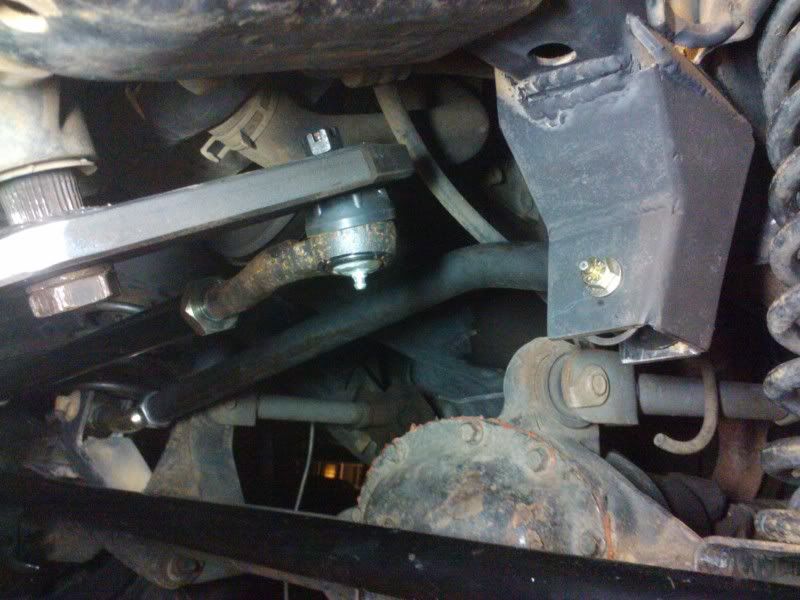

make one... bout your best bet... i bought the jks builder tracbar and bent it myself to clear the diff. couldnt really find anything else that would clear with only 2.5" of lift and stock bump stops
you can kinda see it under there
youre wheelin on borrowed time with that much shock travel and stock susp, those bushings were never designed for that much deflection and that puts a ton of strain on the brackets... and to be honest, i find it hard to beleive youre even using all of it... IIRC the stock trac bar mount with the stock trac bar only allows like 6" on down travel. AND with my custom long arrm i max out my CV in the front ds at about 12" of down travel (so 14" from static ride height of a stock rig) and thats with a HP30 and much better pinion tracking than the stock geometry

Any more pictures? Sounds similar to where im going with mine.

LOTS! check my build thread in my sig...
heres the JKS trac bar when i first did my Wj swap but still had stock susp geometry
