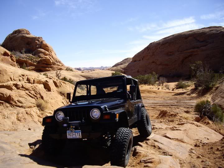

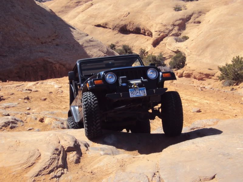

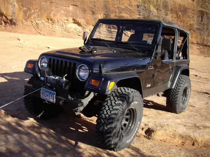

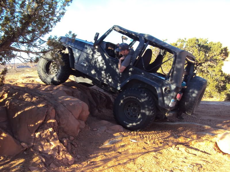

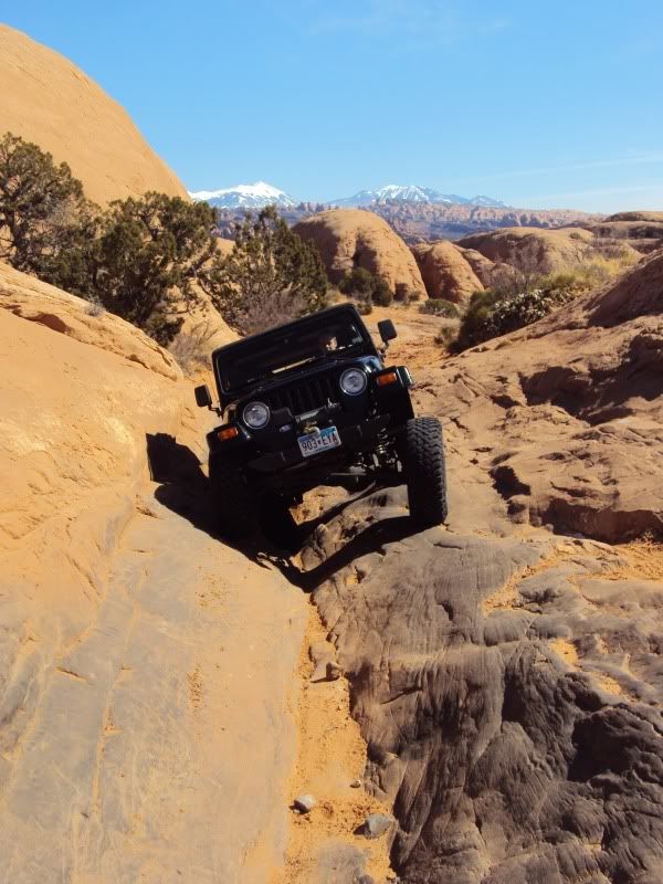

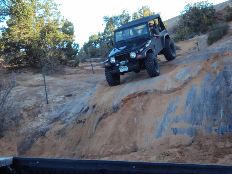

My rig probably isn't considered low center of gravity "done right"...YET... For now, yes it has a low center of gravity, but, I am still working toward the "done right" part on a college budget. For the time being, if I break something, I will have to deal with it and fix it as I go...I'm carrying spare parts and expecting failure which is yet to happen (but most likely inevitable). Sure it looks kindof cool (I think), flexes alright, and performs decently for where and how I wheel it. But it could be better. And eventually, it will be better. As finances allow, it will receive more fender clearance, shock relocation with longer travel shocks, axle, brake, and steering upgrades, and a belly up. For the time being I will continue to wheel it and enjoy it as I upgrade.
On a side note, I feel the whole "done right" concept is applicable to all rigs, whether considered to have a low center of gravity or not, and is very important. I also think that most of us have an idea of what is "right" and are doing what we can to work toward that...and not for the approval of random people on some forum but for our own good, so we aren't stuck out in the middle of nowhere in the rocks with a bent tie rod or broken axle shaft.
Anyhoo...Correctly built yet or not, here are some pictures of my "35s on 3" of lift TJ" wheeling in Moab a couple weeks ago.
