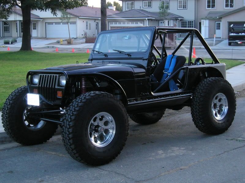

post #2653 of 3465 Old 03-07-2014, 02:17 PM
jasonswelding
Location: Blanchard
Posts: 405
jasonswelding is offline

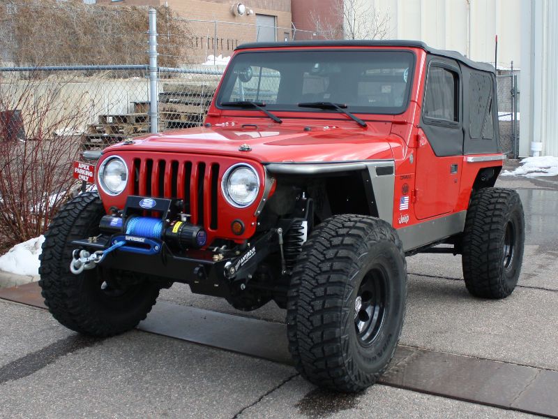

Posts: 574
Not sure if it qualifies for LCOG, but it is on 35s with 2.5 inches of lift.
Just my opinion, yours will differ.
