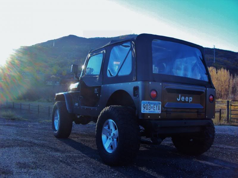

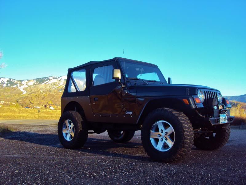

Time to get this thread back on track with some pictures..
1" body lift, xj leafs in rear, 1 3/4" spring spacers up front. 98" wheelbase on 35s.
One of my favorites on the forum. So clean.
I am aslo stretching, why did you go with leafs? Cost?
wow thats nice. got a build thread ?
so 1 3/4 spring spacer up front and 1 inch body lift.
i should have no problem doing 35s on a 2 inch suspension lift and a 1.5 body lift cant wait !
agian, really nice clean simple looking rig. any pics of it in action ?
Thanks a lot! It is relatively clean, I hope to keep it that way.Its kindof tough to balance keeping it clean and wheeling it though.
Stability, simplicity and budget. If I were to build another, I'd probably put leafs in the rear again.
stratton.
Thank you! Running only about 3" of lift, you'll need to extend your bump stops. I plan on building some high fenders so I can ditch some bump stop up front. There are a lot of pictures in my build thread. There's a link to it under my post.
