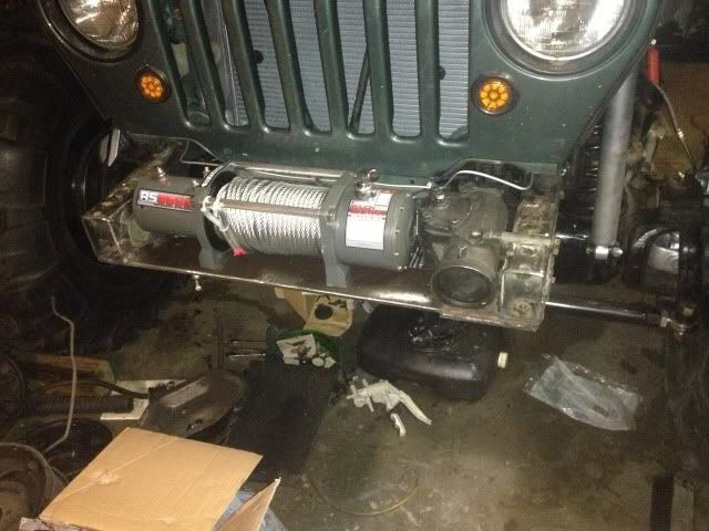

Finally drove mine around the block yesterday for the first time since March. Still more work to do, but it starts, steers, and stops.
Stats:
100" wheelbase (3.5" front stretch, 2.5" rear)
38.5" TSLs (built for 40s)
Dana 70s front and rear
3/4 link
Stock TJ rear springs, ZJ upcountry front springs (heavy 5.9 magnum engine)
1" body lift
12" travel shocks (4" up travel front, 5" up rear)
20" belly @ 30 psi tires
74" windshield
87" width
Near 90* approach
85* departure.
I had to run a waggy pitman arm with the heim on top to clear the tie rod even when located under the knuckle. Tried a flat Astro arm but that didn't work at all. With the drag link located on top of the knuckle I still had to cope the frame 2" or it hit at full articulation.
Full bump:
Beginnings of a winch mount.

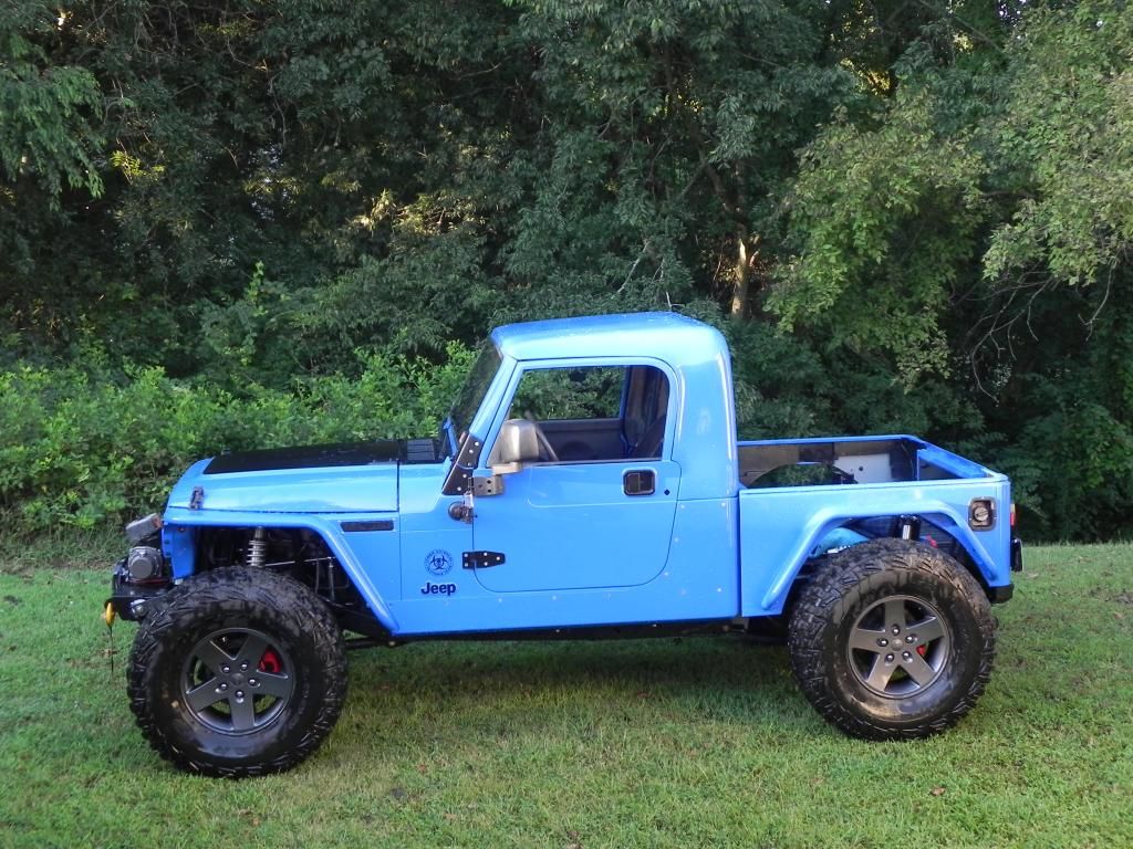

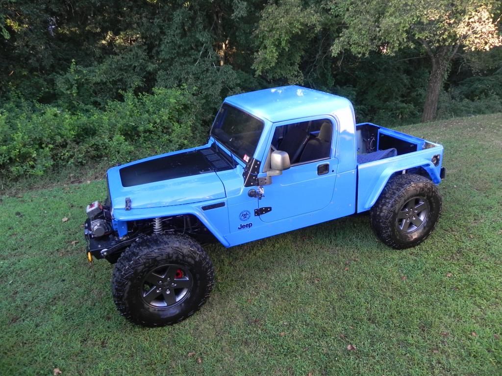

Think I can fit in this category.
37s
Not really sure how much lift 1 over stock.
18" at the center frame.
114 WB.
37s
114 wheelbase
Well I sit at 19" on the center frame with 3.5"ish springs on 33' if that gives you an idea...
37s
114 WB.
Holy crap! That's a clean rig! Very nicely done!
