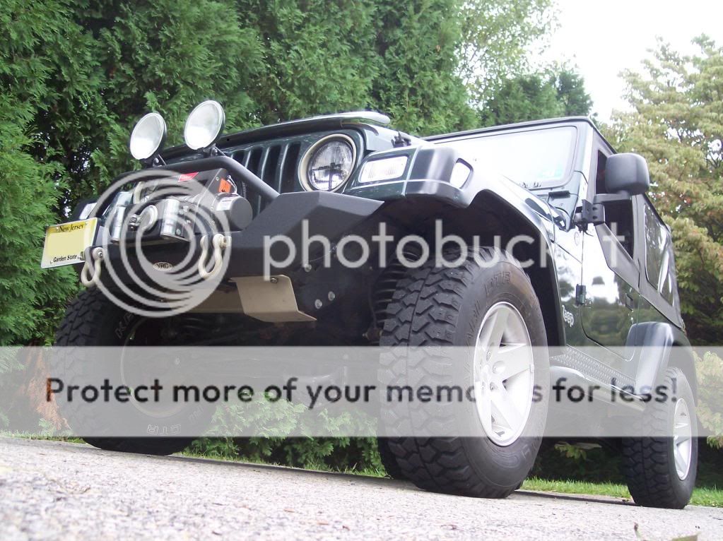

I have 265/75r/16 M/T on 16x8 Moabs with 5" back spacing on my 04 Rubicon with a 2.5" lift and no rubbing or clearance problems.

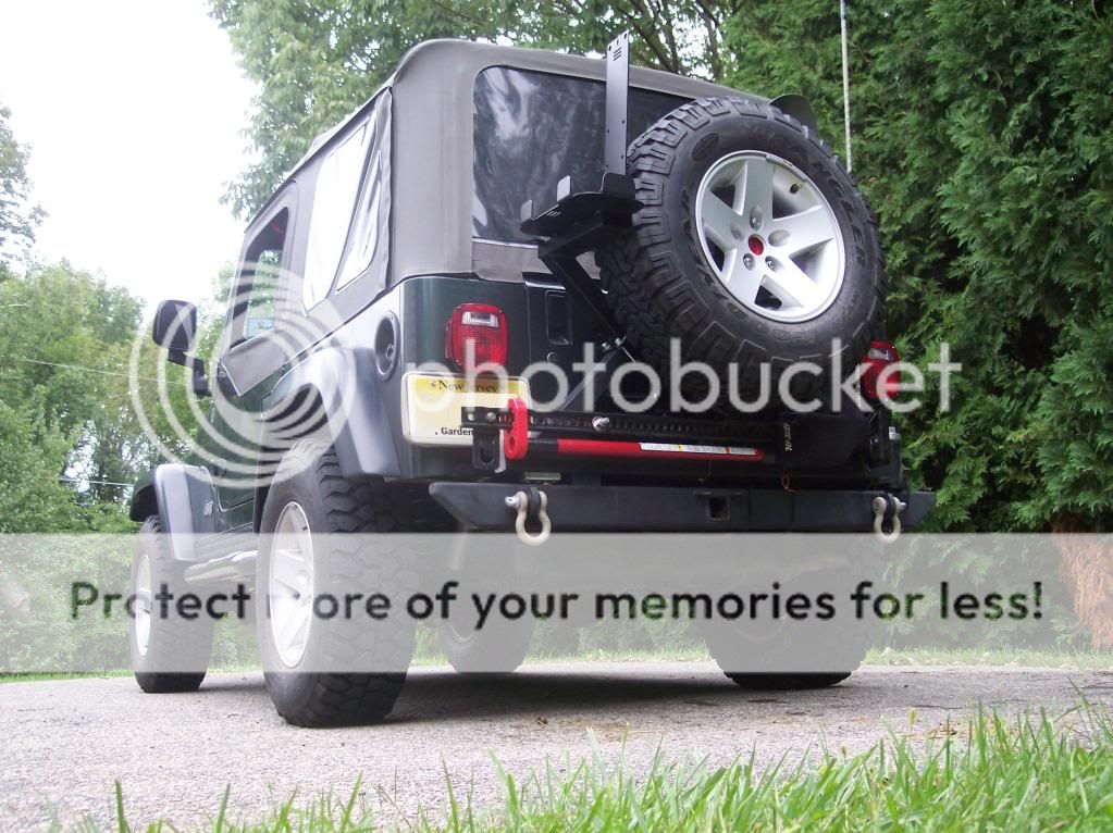

My flares are an inch wider then stock TJ's and the tread is inside the flares and the outside of the sidewall is just outside of the flares. The pictures I have make the tires look a little off. I hope these help.
